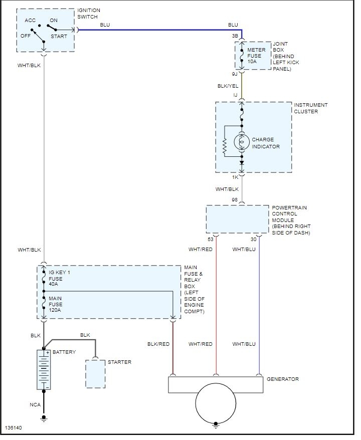

You may have a bad wire,ignition switch or connection somewhere in the charging circuit causing an intermittent issue.
Check out this guide on testing wiring, it will help
Attached below you will find the wiring diagram for your charging circuit

Check the main terminal of the alternator for power with the key OFF. If no power found, check the big maxi fuses. Check all the other fuses also.
