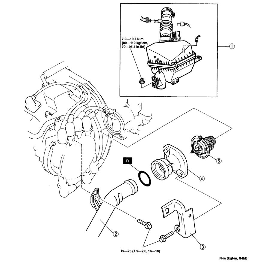

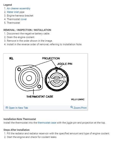

the thermostat is located on the right front of the engine block just behind the distributor
See the attachments below for pictures and instructions
Let us know if you need anything else
