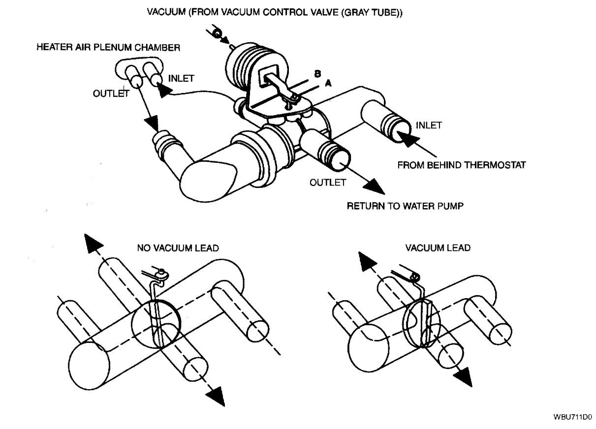

Be sure both heater hoses are getting hot, If only one is hot you may have a plugged heater core or heater control valve that isn't working.
Read the guide below, it will help.
https://www.2carpros.com/articles/car-heater-not-working
The heater control valve is pictured below
