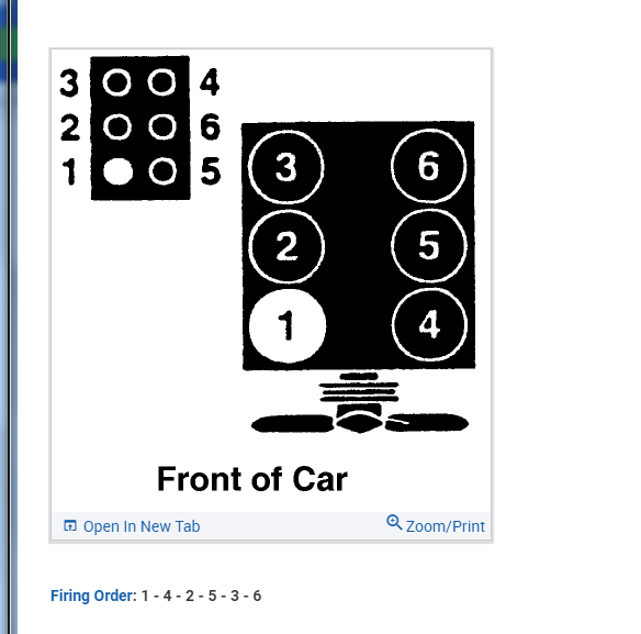

Hello, I am currently trying to change my spark plug wires and like an idiot I removed them all at once. I know. Anyways I need to know which plug goes where. I have the firing pattern from the manual but it really doesent tell me where to connect to the distributor. I just need a simple diagram I guess (for dummies if you will). I appreiciate any assistance.
