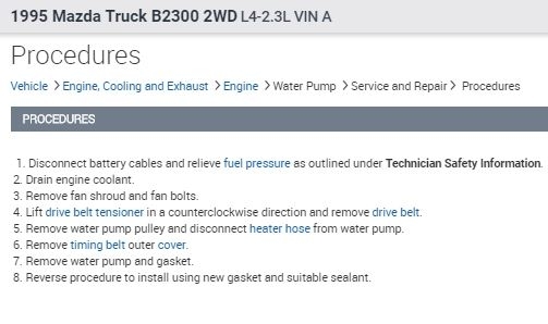

The manual doesn't show any diagrams, but nothing in the instructions warn of hidden bolts. Have you tried tapping on it lightly with a hammer to see if it breaks free?
See instructions from manual below
