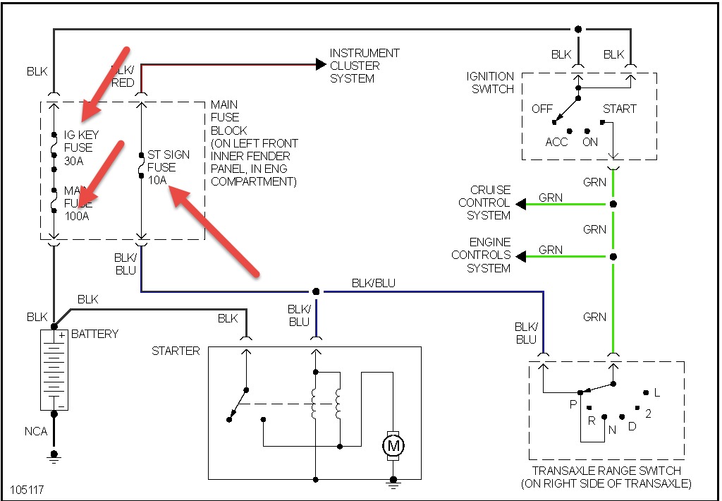

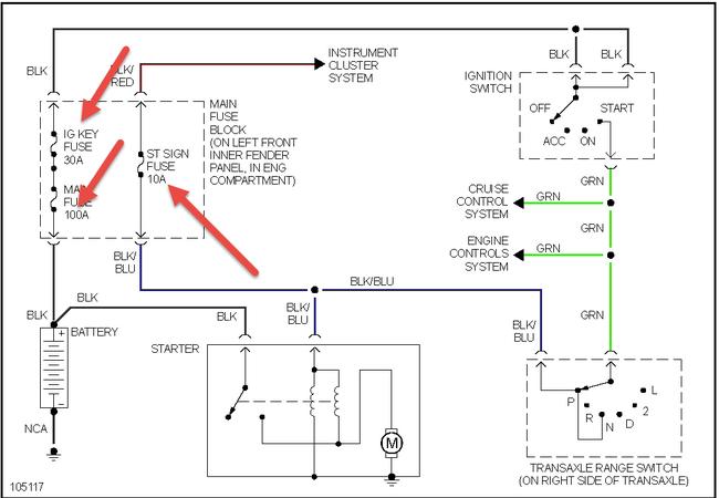

HMAC300
  • 48,601 POSTS
check fuses in pic then check to see if power goes through trans switch if no power through fuses try bending prongs just a tad to see if they will make contact as it may be a fuse box problem or corrosion on fuses
