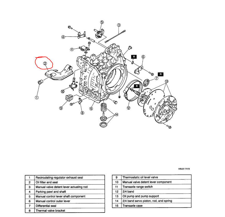

The transmission filter is located inside the transmission pan.
In order to change the filter, the transmission pan needs to be removed. See diagram below.

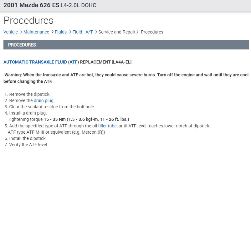

Here is a helpful guide on changing automatic transmission fluid and filter:
