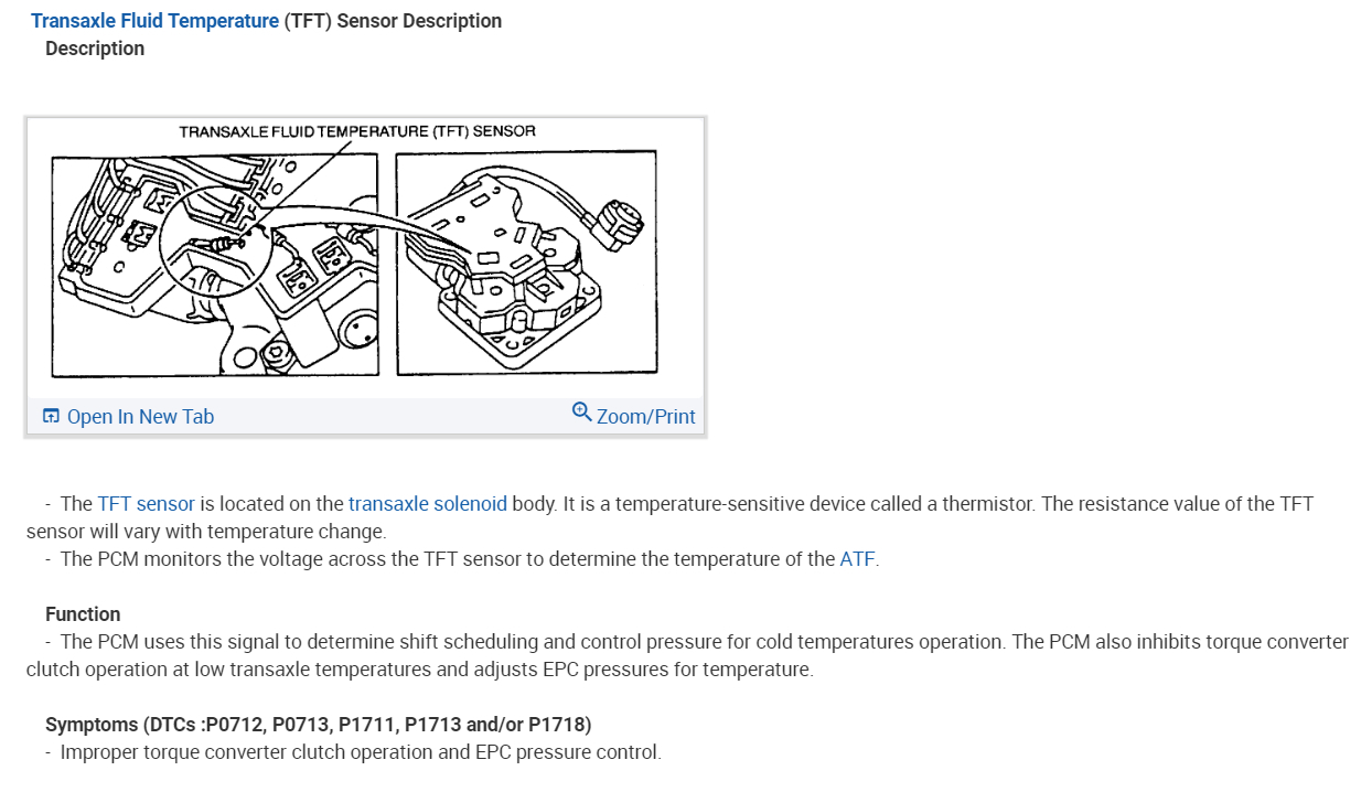

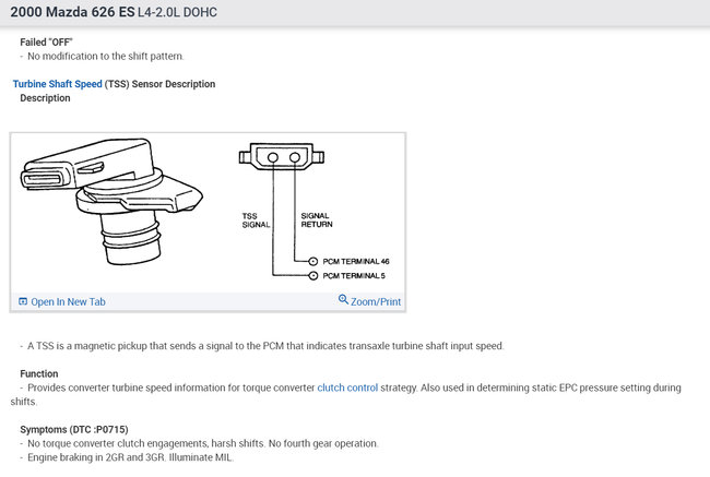

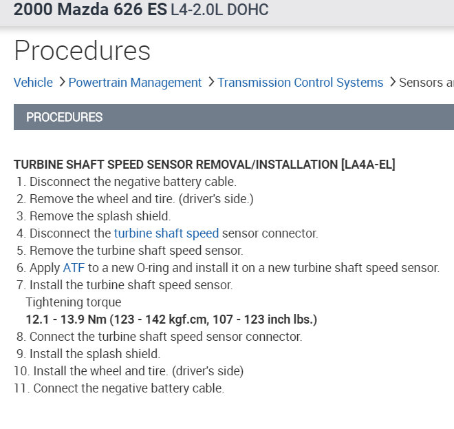

It sounds like it cold be a turbine shaft speed sensor that is not working correctly.here are diagrams and instructions below to help get the problem fixed. Check out the diagrams (below). Please let us know what you find. We are interested to see what it is.
