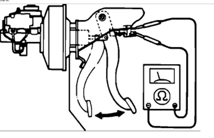

The brake light switch is located by the top of the brake pedal, you can test it using a test light, here is a guide that shows how to test it and a diagram that shows the location (below)
Please run this test and get back to us so we can continue helping you.
