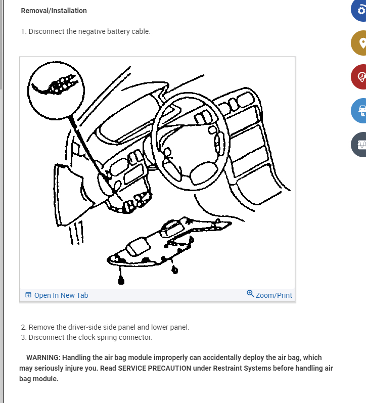

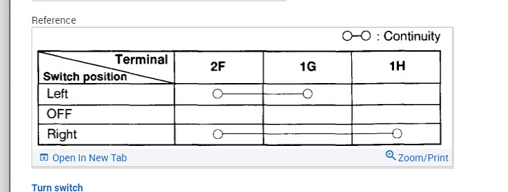

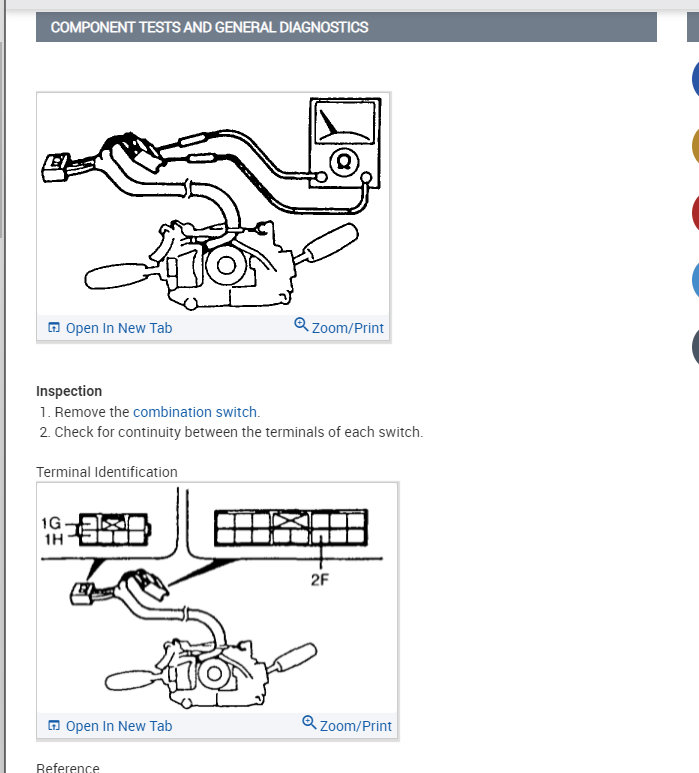

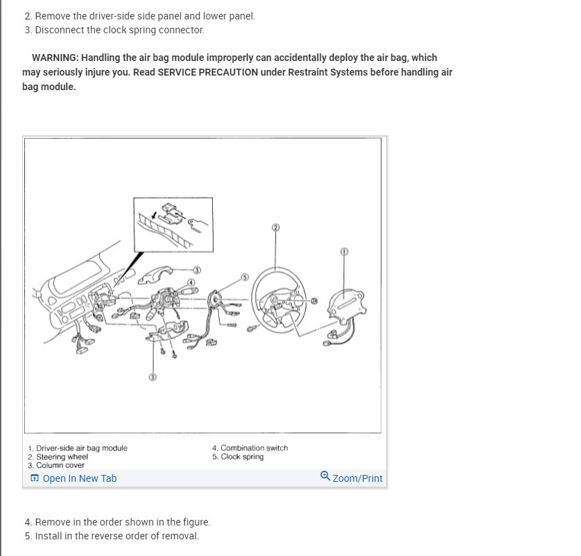

More than likely, you have an issue with the combination switch (multifunction switch) and it is not turning these lights on.
However, we need to test this by using the info below to be sure this is the issue.
Here are guides that will help with this:
Please run through this and let us know what you find or what questions you have.
