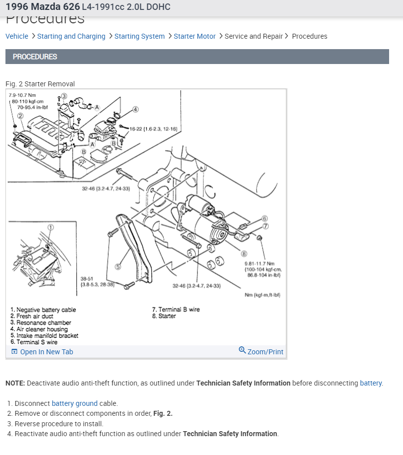

When you turn the key and it only clicks or does not make any noise then the issue could be a weak battery, faulty starter, bad connection to the starter, or an ignition switch. It can also be due to wiring issue.

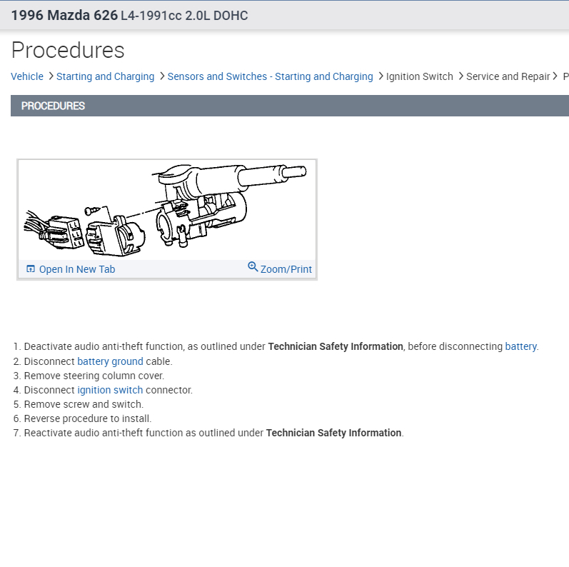

If you are getting no noise while trying to start it could be due to a bad ignition switch. The ignition switch is the electrical component that the lock cylinder attaches to.
Over time it can have burnt pin(s) and can cause the engine not to start.
