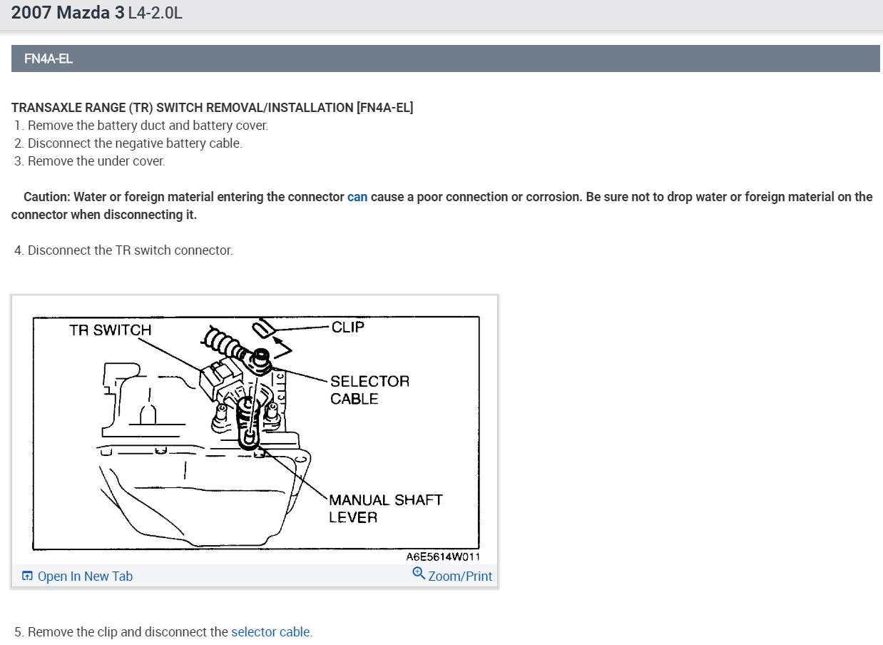

I have a 2007 Mazda 3. I went to start it today and it wouldn't start. No sounds when i turned the key, but all the lights, radio, etc. work. Then i tried turning it on, putting it in neutral, and starting it and it starts right up. Now it will only seem to start in neutral. What could be the problem?

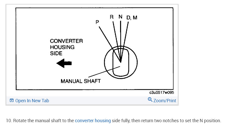

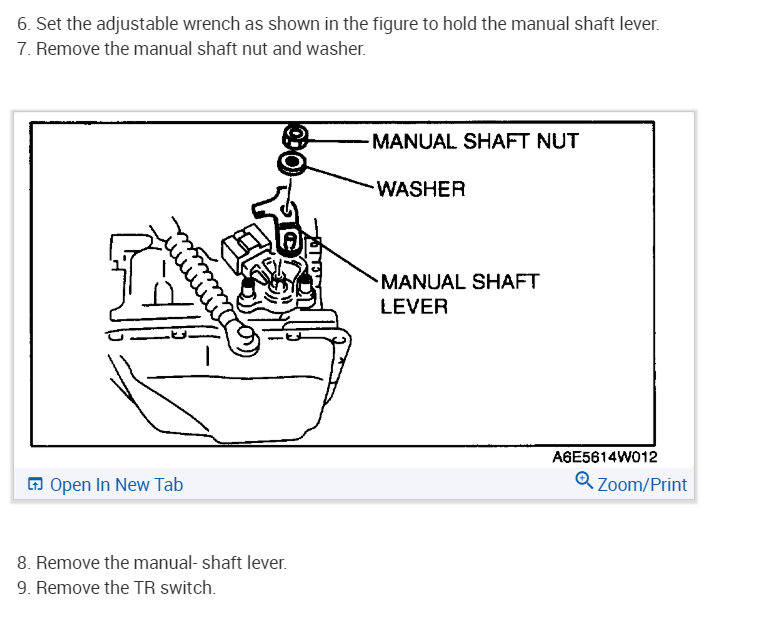

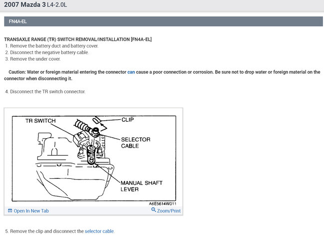

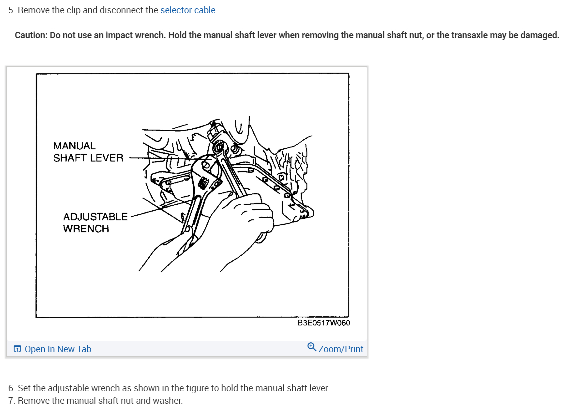

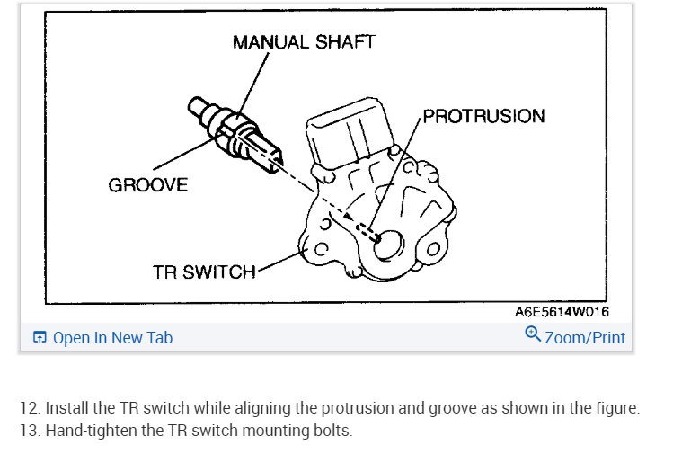

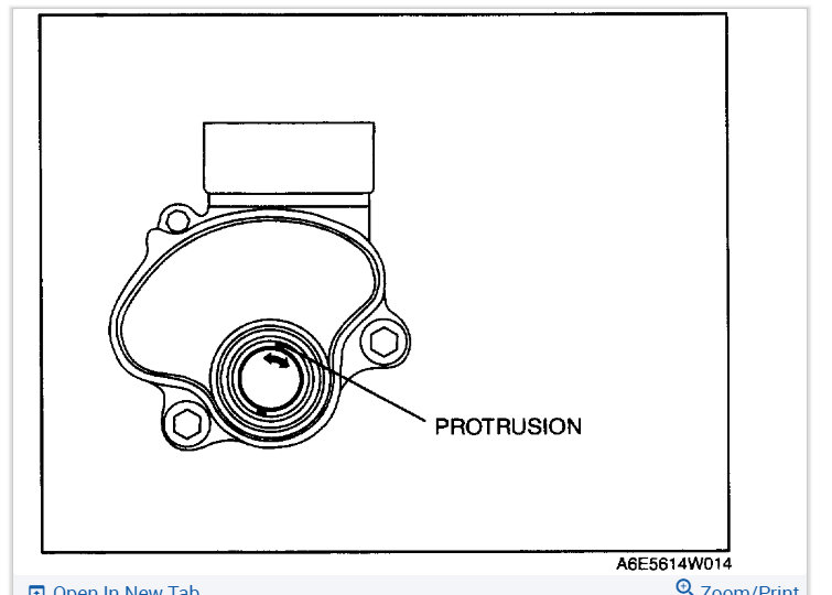

It sounds like the transmission gear range sensor is not working here is the location in the diagrams below to show you how to fix it. Check out the diagrams (Below). Please let us know if you need anything else to get the problem fixed.
