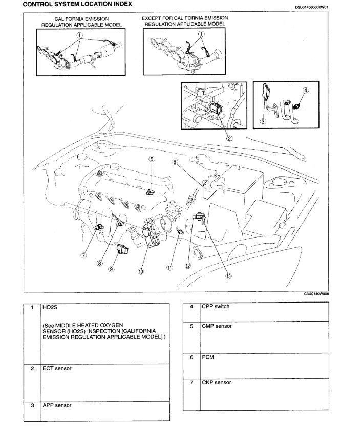

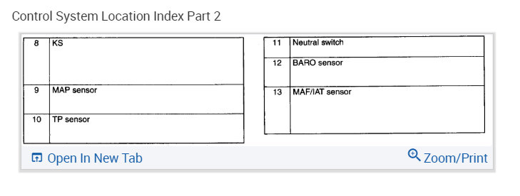

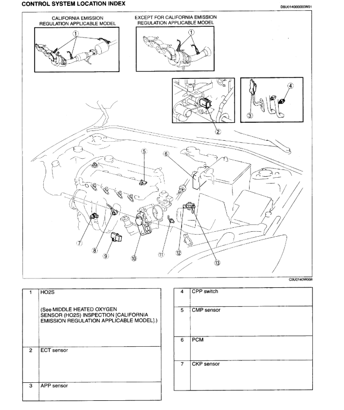

Speficatly, Where is the coolant sensor located on the engine as you faced it?
Mar 22, 2010 at 12:50 PM
LEGITIMATE007
  • 5,121 POSTS
Here is the location of the engine coolant temperature sensor in the diagrams below. Check out the diagrams (Below). Please let us know if you need anything else to get the problem fixed.

Code P0128 - Possible faulty ECT Sensor. Where is it and can I reaplce it, or is it a Dealer issue?
Oct 23, 2019 at 2:23 PM (Merged)
RASMATAZ
  • 75,992 POSTS
Its on top for rear of engine
