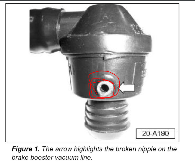

If it is hard to press, that would likely indicate a vacuum leak to the brake booster. It is common for a plastic nipple that is molded into the connector.

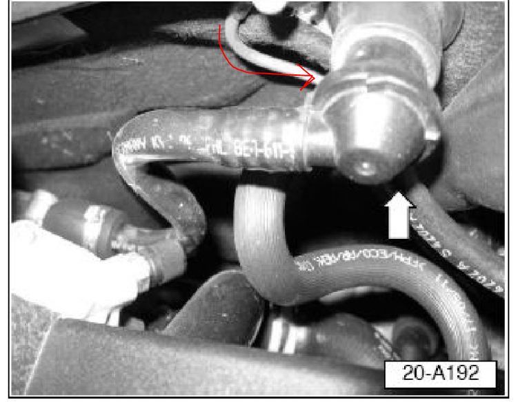

Check for a broken nipple on the vacuum line leading to the brake booster. The brake booster vacuum line is located between the engine and the bulkhead on the left side of the engine compartment, connected to the front of the brake booster unit.
I attached two pics below to help locate and identify if this is the problem.
Let me know what you find or if I am incorrect about what is happening.
See pics below.

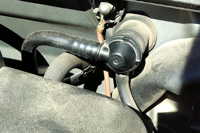

i looked at the part you pointed out and took a picture of it. i gently moved the hoses and there's nothing broken on them and there's no leaking around the hoses.
