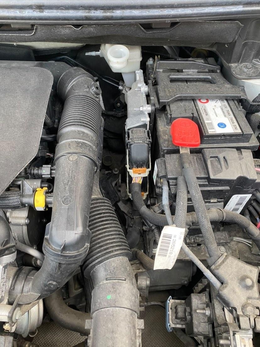

This is the problem i have. As you can see there are no vap.

A salvage yard is the perfect place to find an inexpensive replacement. I'm in the U.S. We have a number of yards popping up where you go in, take your own tools, and you can wander around all day if you want to. In the meantime, it would be smart to put something over the opening to keep engine oil vapors from getting into the brake fluid. Plastic wrap or tin foil with a rubber band would be better than nothing until you can get a replacement cap.
