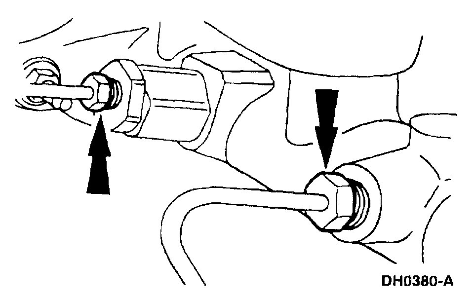

pic 1

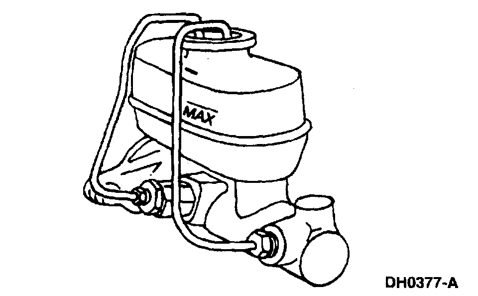

pic 2
1. For in-vehicle priming, disconnect the brake lines.

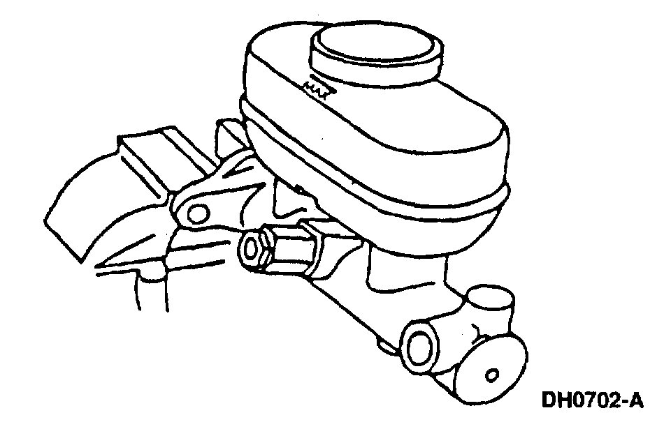

pic 3
2. For bench priming, mount the brake master cylinder in a vise.

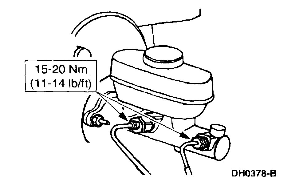

pic 4
3. Install short brake tubes with the ends submerged in the brake master cylinder reservoir, and fill the brake master cylinder reservoir with High Performance DOT 3 Brake Fluid C6AZ-19542-AB or equivalent DOT 3 fluid meeting Ford specification ESA-M6C25-A.
4. Have an assistant pump the brake pedal , or slowly depress the primary piston until clear fluid flows from both brake tubes, without air bubbles.

7. Bleed each brake tube at the brake master cylinder as follows:
1 Have an assistant pump the brake pedal, and then hold firm pressure on the brake pedal.
2 Loosen the rear most brake tube fittings until a stream of brake fluid comes out. While the assistant maintains pressure on the brake pedal, tighten the brake tube fitting.
3 Repeat this operation until clear, bubble-free fluid comes out.
4 Refill the brake master cylinder reservoir as necessary. Repeat the bleeding operation at the front brake tube.
