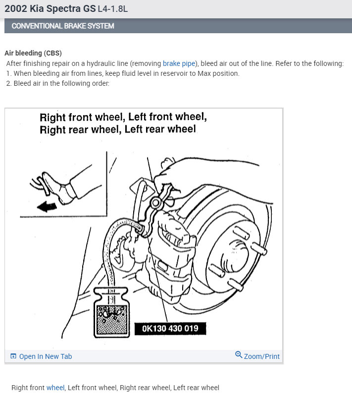

What is the proper brake bleeding sequence for this vehicle?
Feb 16, 2016 at 2:22 PM
SQM
  • 6,383 POSTS

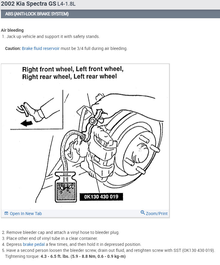

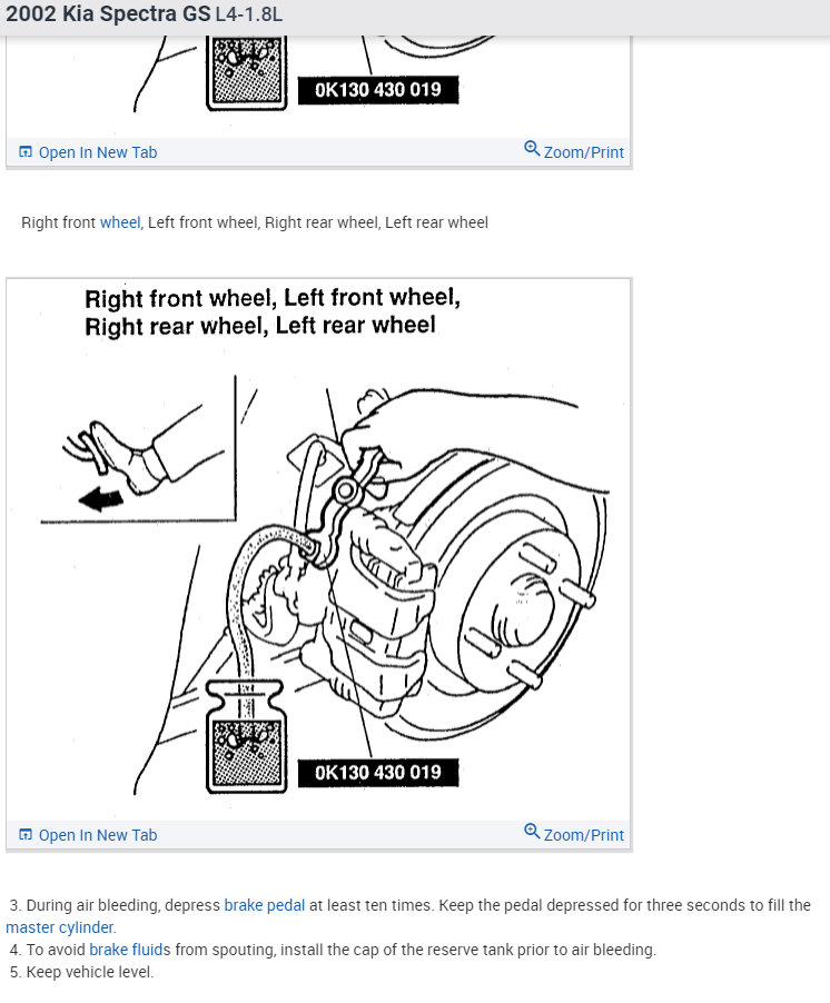

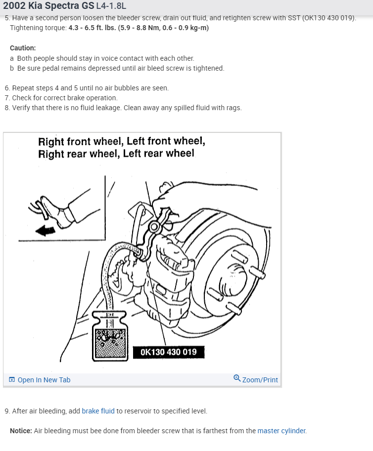

Depending on if the vehicle is equipped with ABS or non-ABS brakes, the procedure is little different.
I have attached the procedure for both brake systems.
