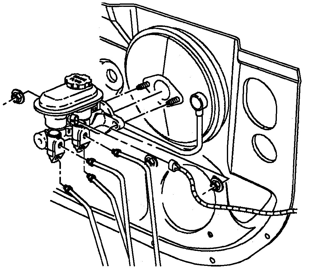

1. Disconnect negative battery cable.
2. Remove brake fluid level switch electrical connector from master cylinder reservoir.
pic 1

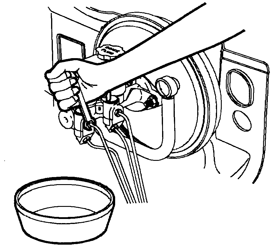

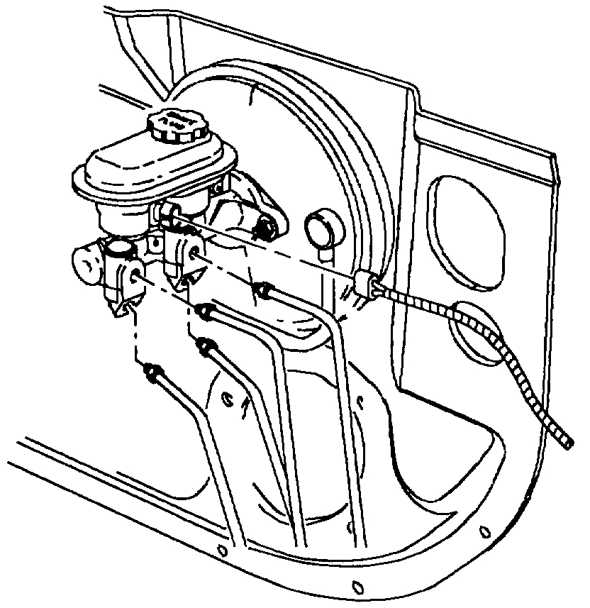

3. Remove brake pipe nuts from master cylinder.
NOTICE:
^ After removing brake pipe nuts, do not excessively pull or bend brake pipes away from master cylinder.
^ Plug open brake pipes to prevent brake fluid loss and contamination.
pic 2

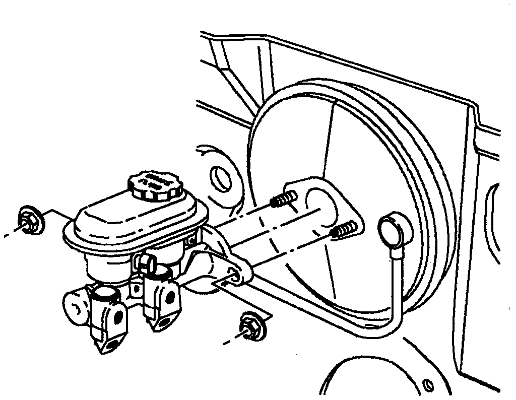

4. Remove two master cylinder-to-brake booster attachment nuts.
NOTICE: Be careful not to bend brake pipes.
5. Remove master cylinder.

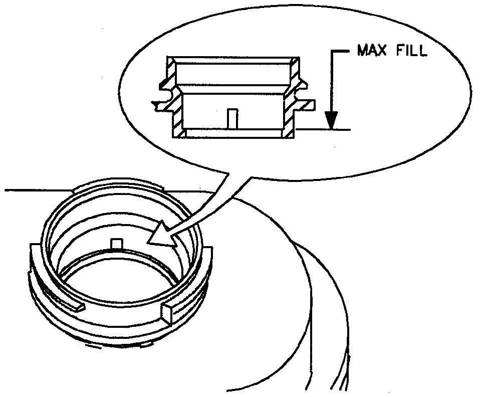

1. Position master cylinder onto brake booster studs and install fastening nuts.
^ Torque: 27 Nm (20 ft. lbs.)

2. Position brake pipes into the master cylinder and secure brake pipe nuts.
^ Torque: 32 Nm (24 ft. lbs.)

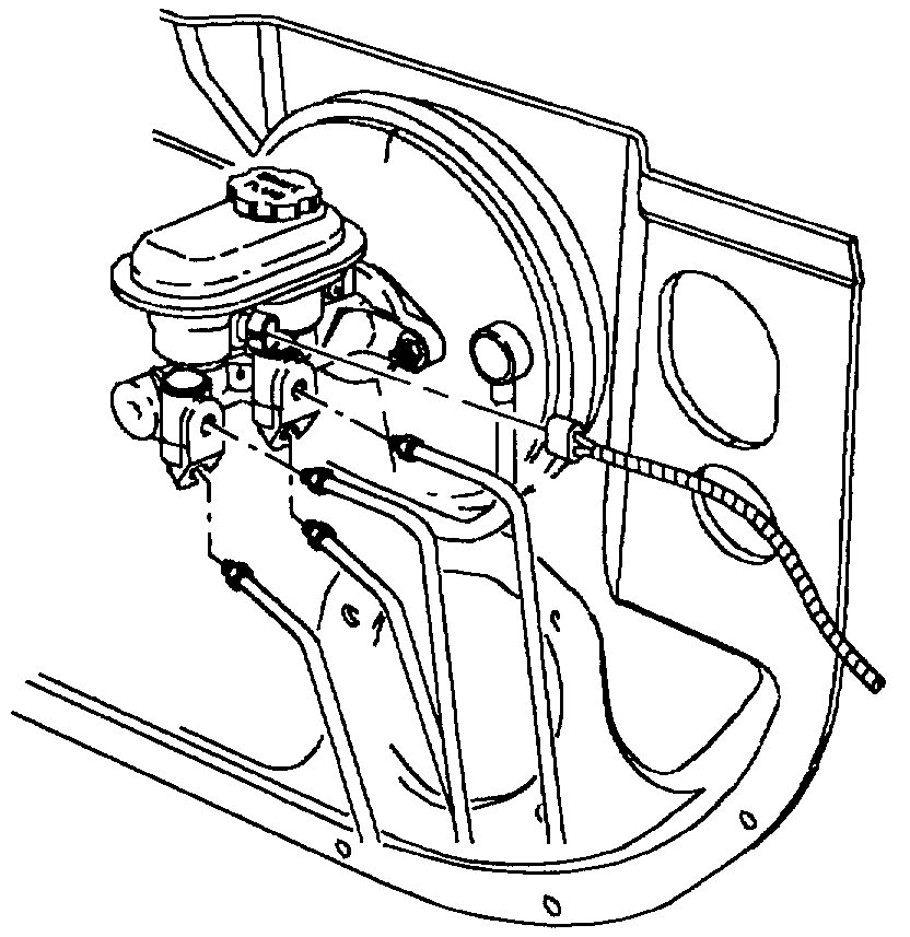

MANUAL BLEEDING PROCEDURE
Conventional (Base) Brake Bleeding
pic 4
1. Fill the master cylinder reservoir with brake fluid. Keep reservoir at least half full during bleeding procedure.

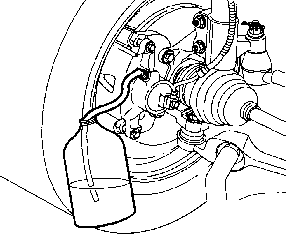

3. Bleed individual calipers and wheel cylinders.
a. Place wrench over bleeder valve.
b. Attach transparent hose over bleeder valve nipple. Submerge other end of hose in a transparent container of brake fluid.
c. Loosen bleeder screw.
d. Apply brake pedal slowly and hold.
e. Tighten bleeder valve.
^ Torque: 11 Nm (97 inch lbs.) front
^ Torque: 7.5 Nm (66 inch lbs.) rear
IMPORTANT: To assist in freeing entrapped air, tap lightly on caliper casting with a rubber mallet.
f. Release brake pedal.
g. Repeat sequence until all air is removed from brake pipes.

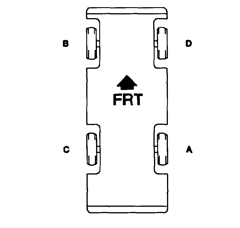

4. If more than one brake pipe is being bled, bleed in the following sequence:
a. Right rear
b. Left front
c. Left rear
d. Right front

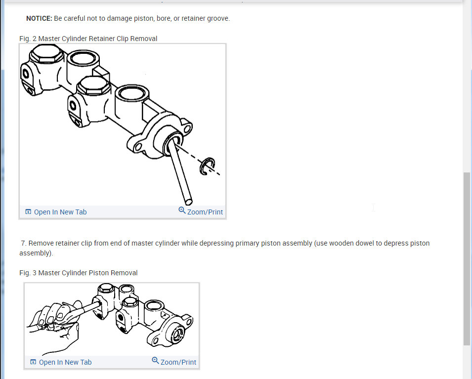

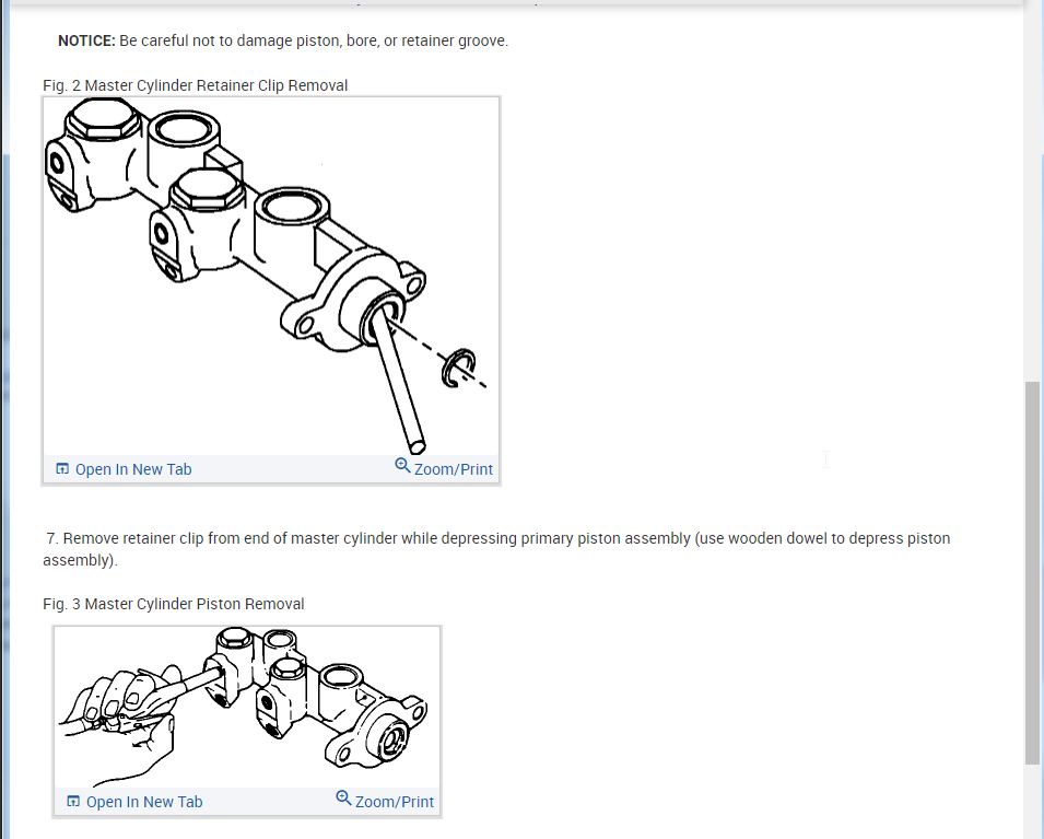

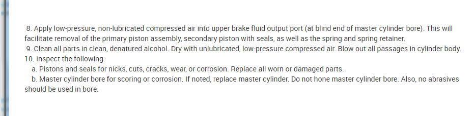

However, if you want to rebuild it, below is the process on how to do that.

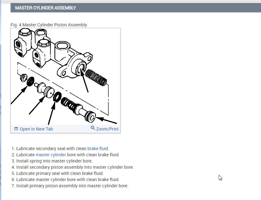

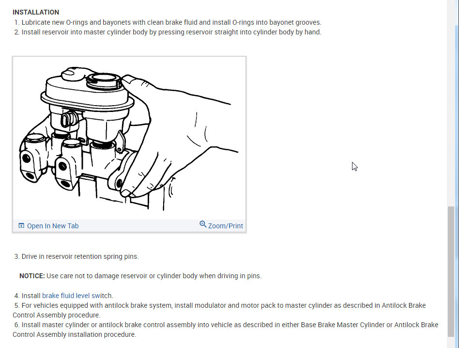

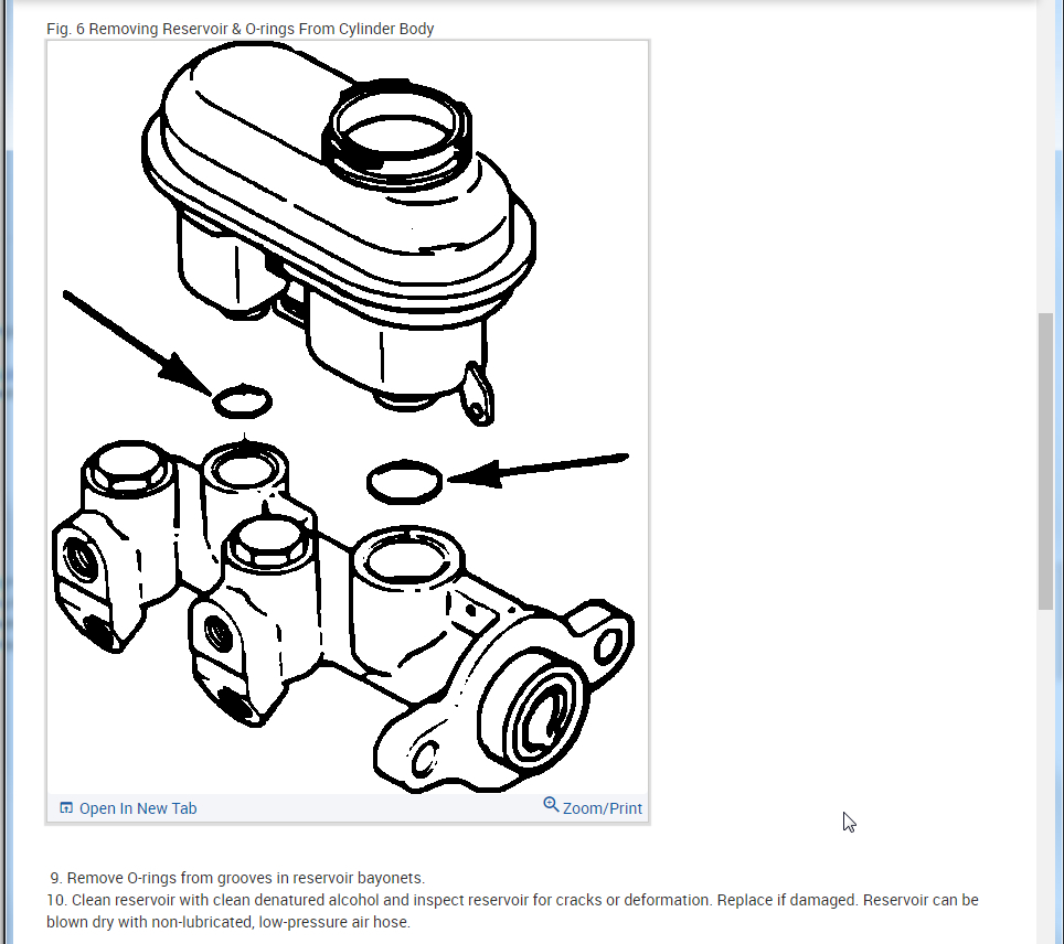

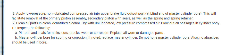

Sorry if we didn't answer that. You mean the o rings shown in the second picture attached below? If you have cracks in those then I would assume you would have a leak.
Or are you talking about the rubber diaphragm under the cap? If that is damaged then yes, you need to replace that. This is responsible for keeping air and moisture out so you may just have water in your fluid which will require flushing the fluid.
