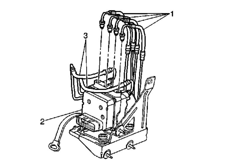

Good afternoon.
The larger lines, the front top and bottom are the fronts. All four lines go to the ABS module and then out to each wheel.

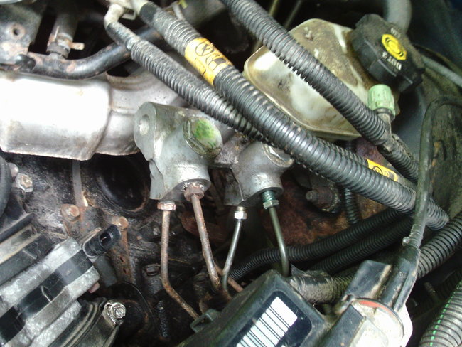

I see nothing as an ABS light when key is turned on, and according to you, if you look at the picture the two lines at rear of master cylinder look new. That is the two new lines that go new all the way back to the rubber lines at tires. So, we are very concerned, and confused as to how we got fluid spitting out of an old line. Is it possible to have an proportioning valve (module) somewhere tucked down by sub-frame, (under engine)? Cannot find anything.
Mar 8, 2021 at 10:52 AM
The smaller lines in the rear go to the rear wheels. If you do not have ABS then there are metering valves in the lines. One for each line. They will look like a connector connecting the lines. They are usually located back by the rear tires.

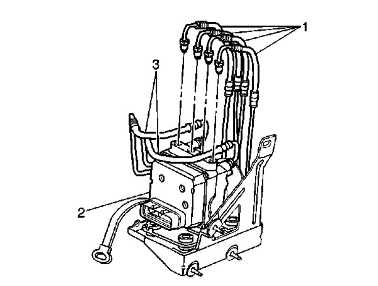

You do not see this unit down low under the cruise control unit?

I see nothing that looks even close to that. We are thinking at some point someone totally removed this module. I have seen where there should be something plugged into something, but there are no wires going to or from any tire.
Can you upload some pictures of what you see?

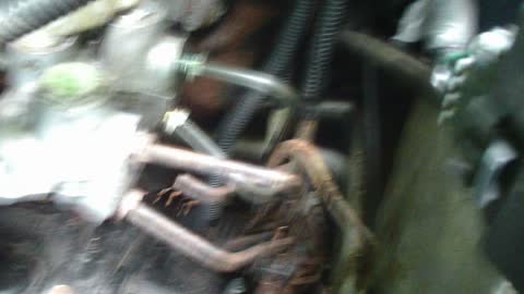

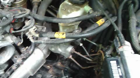

HKFROMNY.
  • 112 POSTS
I think this video should explain the issue. Not what either of us assumed. I think this proves someone changed stuff earlier on.
Okay, the check valves or metering valves are in the master cylinder. The back lines are one front wheel and one back wheel. It is a split diagonal system this means you have right front and left rear applying at the same time and the left front and right rear at the same time. This helps prevent brake pull.
Do not change any position of the lines.
