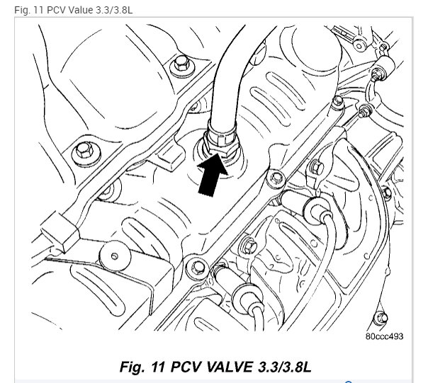

That is an interesting one. I do have a question. If you open the oil fill cap when the engine is running, is there a lot of pressure coming out? I ask because we may be building too much crankcase pressure due to a faulty PCV valve.
See pic 1 below. Remove and inspect the PCV valve as well as the hose to make sure nothing is clogged.
Let me know what you find.

No, there's nothing clogged in the hose for the PCV valve the bottom where it threads into the valve cover did crack off, so I took a hacksaw and just made it even about three or four threads up from the bottom and even cut screwed it back in nice and easily it threaded right in not cross threaded not sitting crooked nice and straight as it's supposed to be. As far as pressure coming out of the other valve cover very little bit of air coming out I put my whole hand over it and can barely feel it with my palm over it. so, thankfully not too much pressure there. I do have a lot of whining going on though from power steering pump going out. when I bought the vehicle it was whining really bad so I took off the reservoir cleaned it really well the screen and let it dry out then put back on vehicle and then let it quieted it down tremendously, but now it's whining pretty good on the pulley side. Sorry it took so long to reply back I was under car and phone didn't make any noise I will monitor it now if you reply back. thank you
