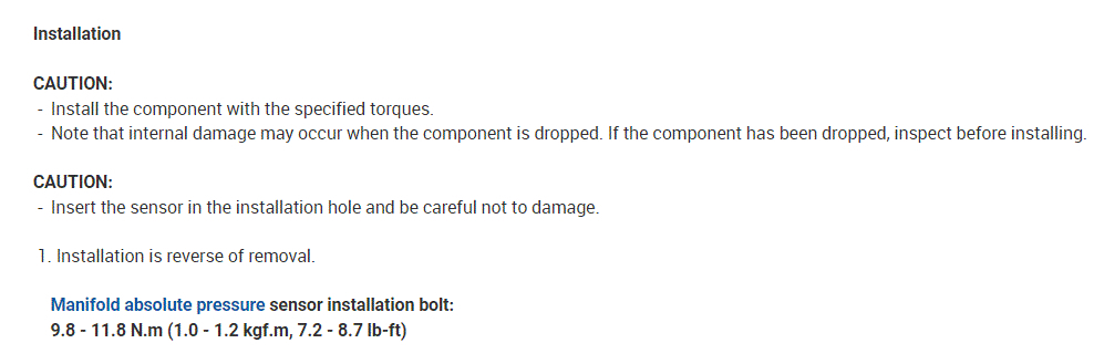

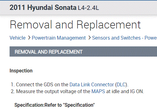

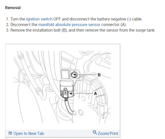

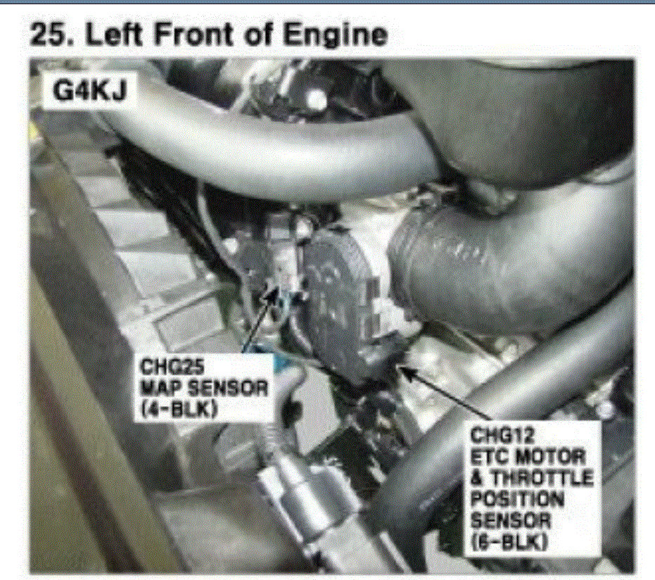

The MAP is located on the left side, in front of the engine. See pic 1 below. The remaining pics are the directions specific to removal and replacement.

See pics below.
