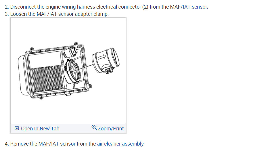

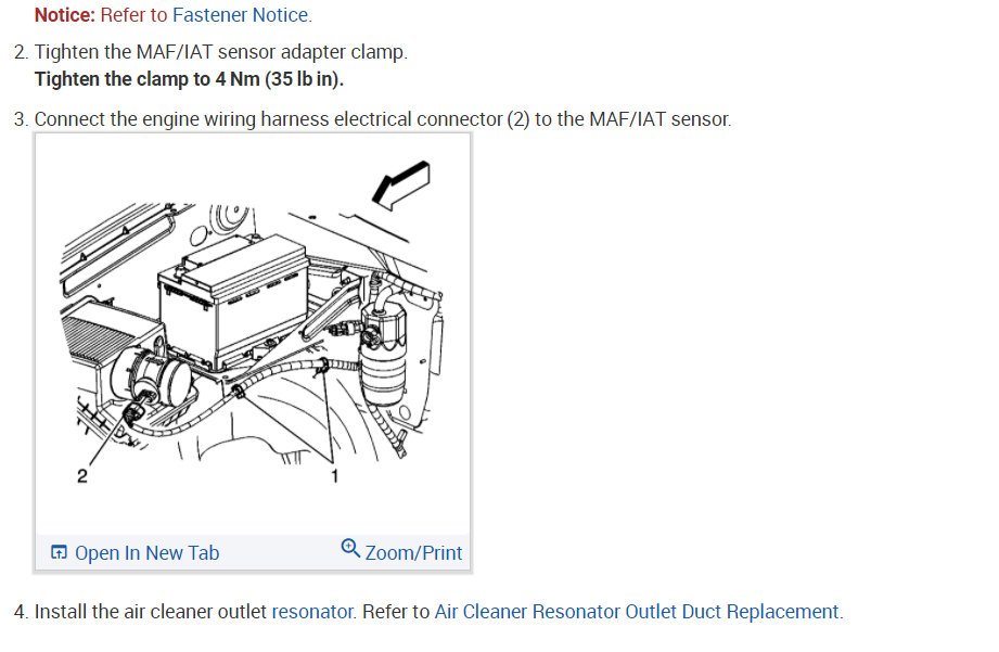

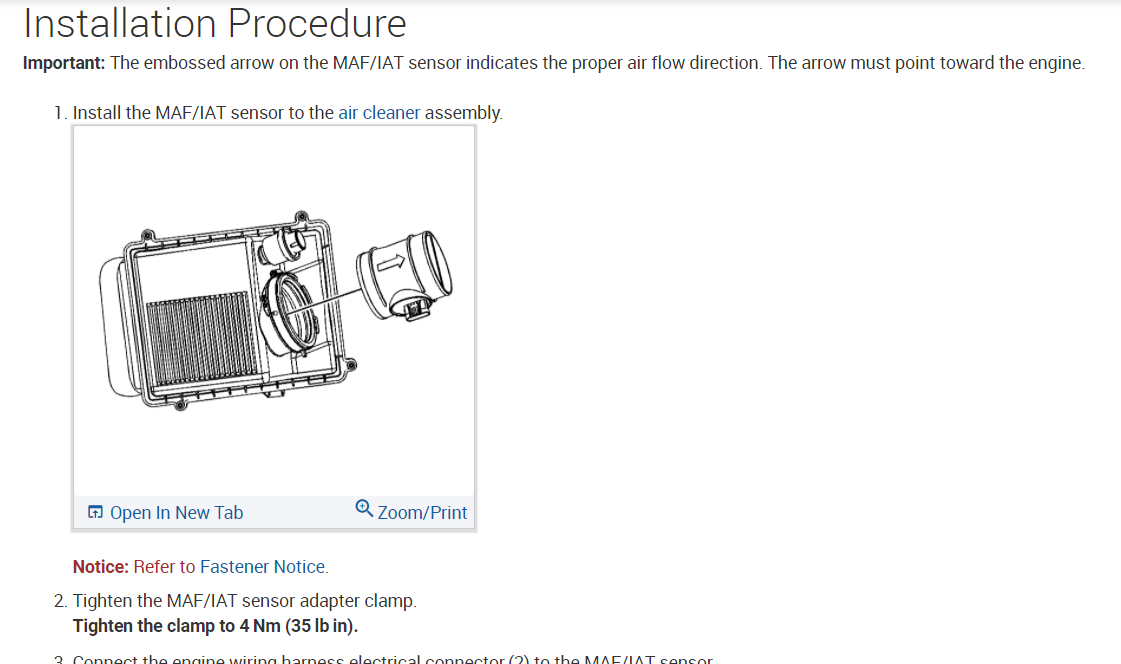

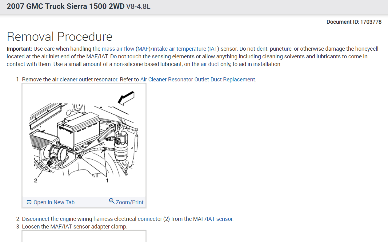

It sounds like the sensor is no good because the air temperature sensor is inside the MAF sensor. I would make sure it is installed correctly and if so get an ACDelco unit from Amazon or Rock Auto. Check out the diagrams (below). Please let us know what happens.
