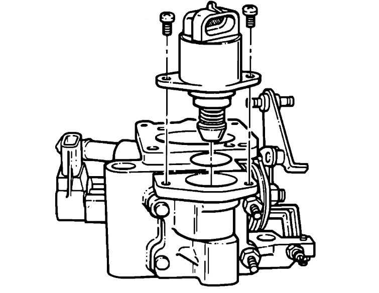

As far as the hard starting, pumping the gas pedal does nothing. The idle air control is what has to be open for the engine breathe and start off every time you start it. This is a common failure for just this issue.
https://www.2carpros.com/articles/how-to-replace-an-idle-speed-control-motor-iac
