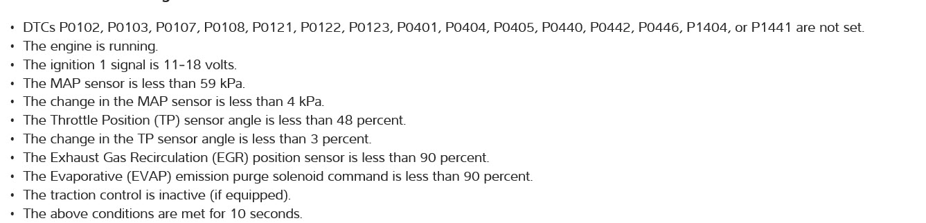

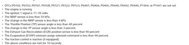

check items in picture it may be a vacuum leak by map sensor or the intake air temperature sensor or EGR possibly not working right or partially clogged. clean throttle plate as well on both sides and IAC hole with choke cleaner. see picture.
