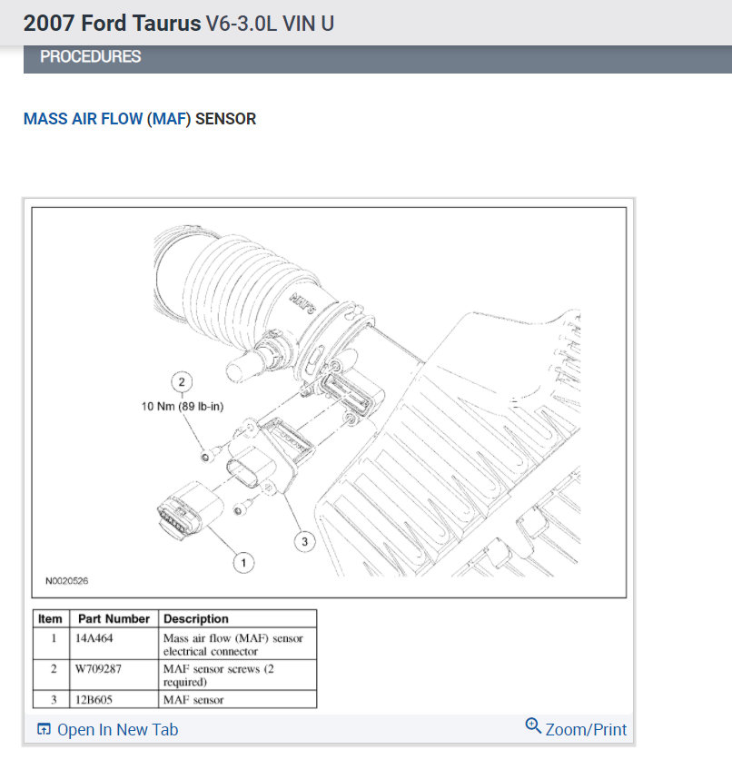

I get codes p0171 and p0174. I cleaned my MAF, but am not sure which way the sensor goes back in. Does the metal looking side of sensor face towards the air filter or does it face the hoses?
Aug 10, 2016 at 6:49 AM
SATURNTECH9
  • 30,869 POSTS

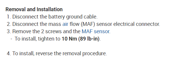

The plastic screen faces the air filter side. Also, sounds like you could very well have a vacuum leak setting those codes. This guide can help find it with the instructions in the diagrams below to show how the MAF sensor is replaced.
and
https://www.2carpros.com/articles/how-to-replace-a-mass-air-flow-sensor-maf
