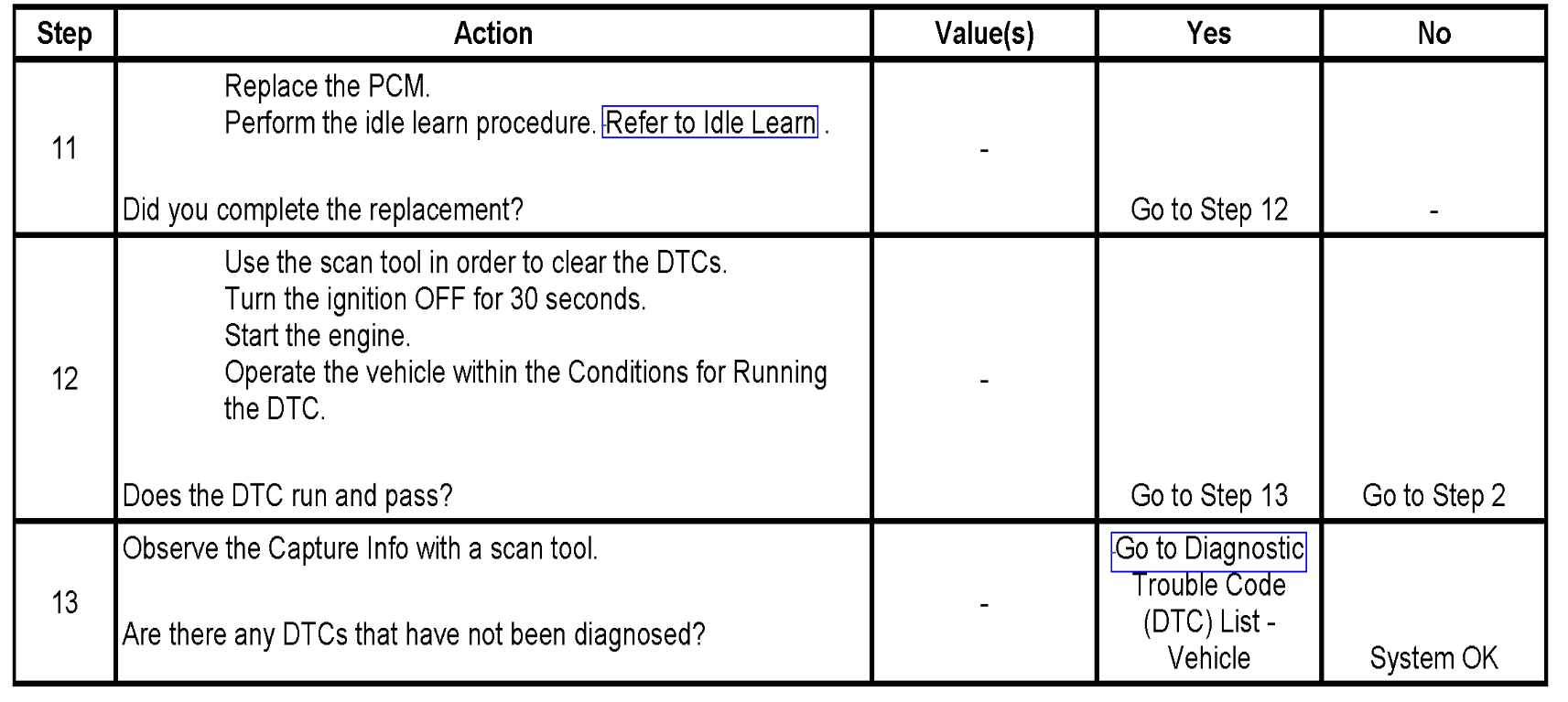

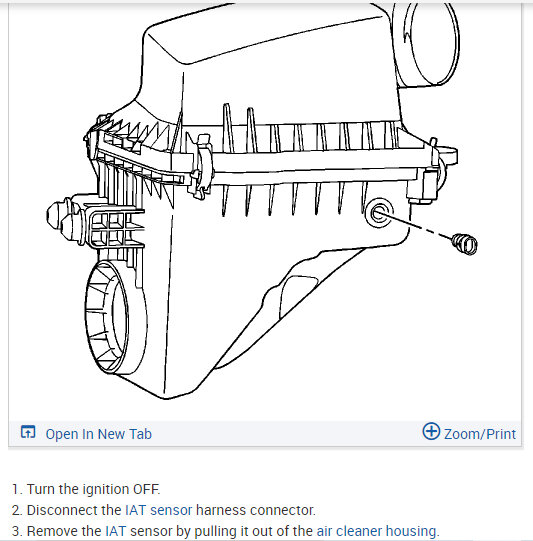

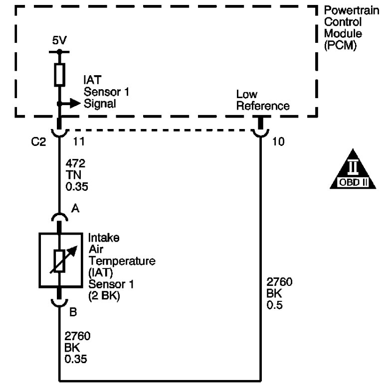

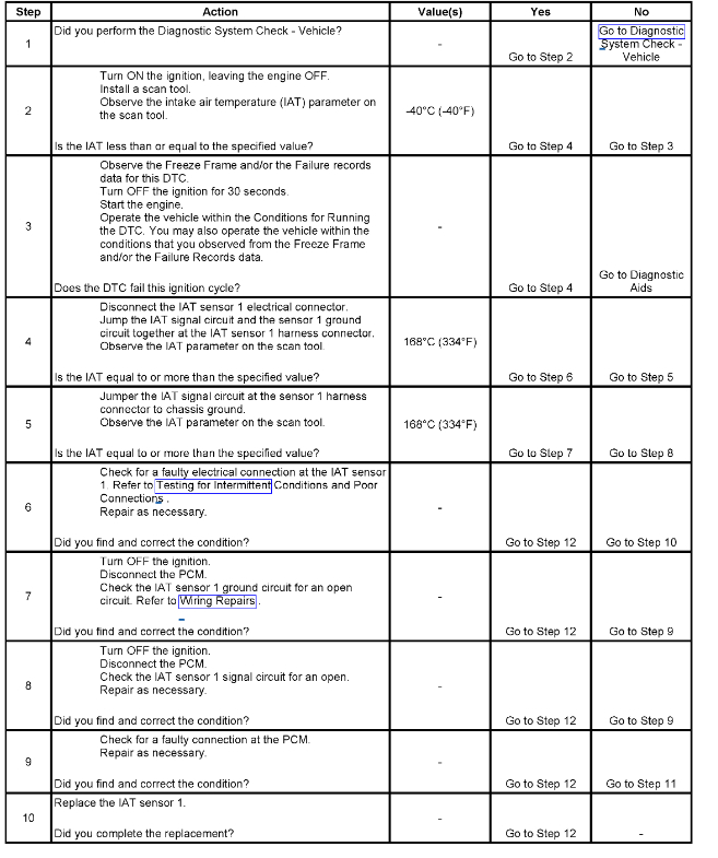

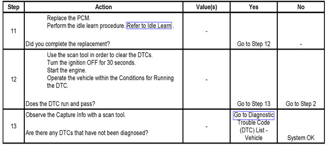

Hello, this code is P0113 (Intake Air Temperature Sensor Circuit High - Bank 1), so it does not indicate a MAF problem. This vehicle has an Air Charge Temperature Sensor that receives this signal. This code requires some electrical diagnosing, but I can walk you through it if you have access to a multimeter.
Please see our guide on how to use a multimeter below:
I will attach the guide for diagnosing this code also as pictures.
(See pic 01, 02 & 03)

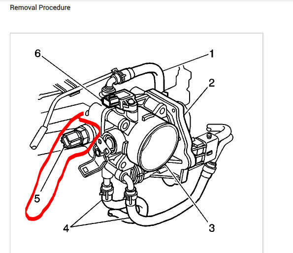

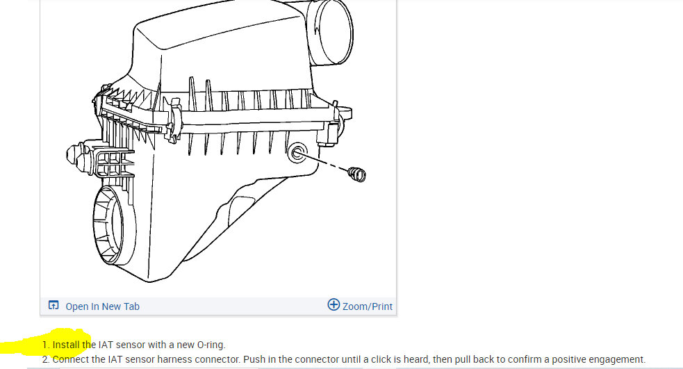

Below I will include the procedure to replace the sensor, it is fairly straight forward.
(See pic 04)
1. Turn the ignition OFF.
2. Disconnect the IAT sensor harness connector.
3. Remove the IAT sensor by pulling it out of the air cleaner housing.
Hope this helps,
William

Did you clear the code after the repair? I attached the diagnostic procedure, in the previous post, it will require a scan tool that can read live data and a multimeter. Even if you can't see live data but have a scan tool, clear the code. If it comes back immediately then we have a likely electrical issue.

Just let us know, we are here to help. The sensor should be receiving 4.9-volts, anything higher results in this code. I would check voltage with it plugged in and unplugged. However, a scan tool will really help you the most here.

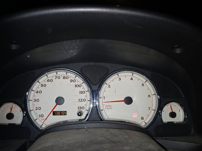

The scanner finally arrived and there were no error codes but my car still has a dash warning and appears to be running hot.
Aug 31, 2024 at 9:32 PM
CANNON1349
  • 861 POSTS
Hello, if I am not mistaken that is the low coolant light. According to your picture the engine temperature is actually good. Can you confirm there is enough coolant in the radiator or expansion tank?
Thanks,
William
Sep 1, 2024 at 7:24 AM
SHERILYN FRANKLIN
  • 90 POSTS
Yes there is, do you see where the gauge is? And why is that light on?
Sep 2, 2024 at 12:01 AM

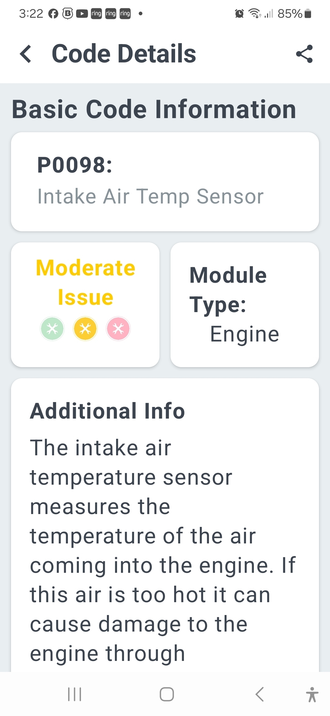

SHERILYN FRANKLIN
  • 90 POSTS
Fixd found the code, yesterday my scan tool said no codes today it had the same error as the fix.

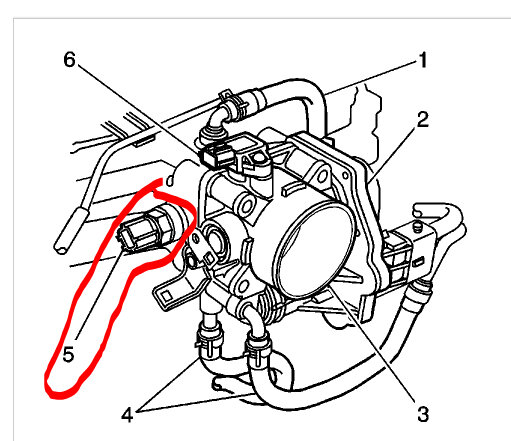

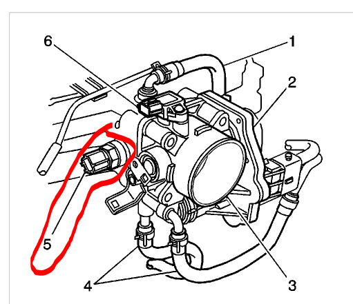

Sep 3, 2024 at 7:33 PM
SHERILYN FRANKLIN
  • 90 POSTS
Intake air temp sensor.
Sep 3, 2024 at 9:19 PM

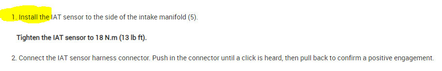

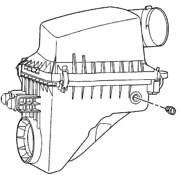

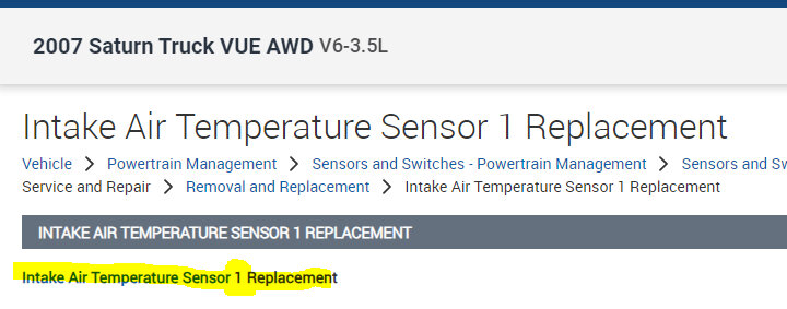

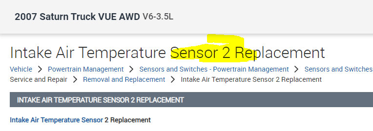

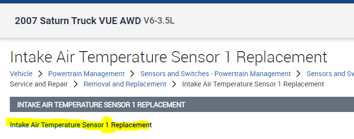

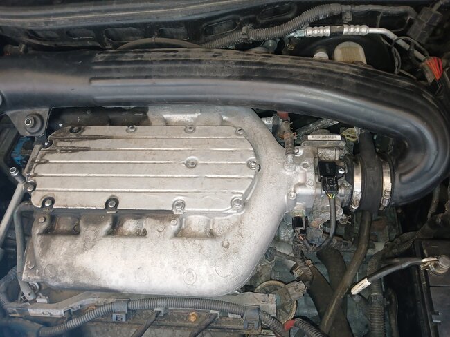

There are two on this vehicle. Yes, you could replace them. It isn't a difficult job.
If you look below, I attached the directions for both sensor 1 and sensor 2. Take a look through them and let me know if that helps or if you have additional questions.
See pics below.
Sep 4, 2024 at 7:33 PM

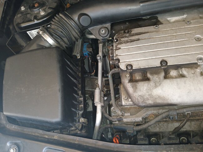

SHERILYN FRANKLIN
  • 90 POSTS
Do I ask for a sensor O ring? I have to find where the intake manifold is, can't tell by the pic.
Sep 4, 2024 at 10:56 PM
SHERILYN FRANKLIN
  • 90 POSTS
I put one at sensor under the air filter, where does the other one go?

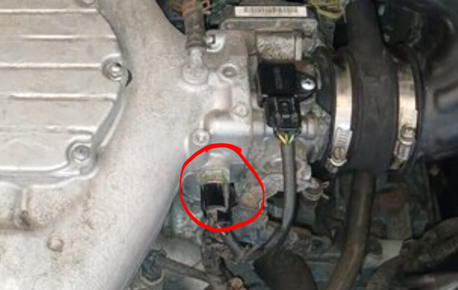

Sep 5, 2024 at 9:52 AM

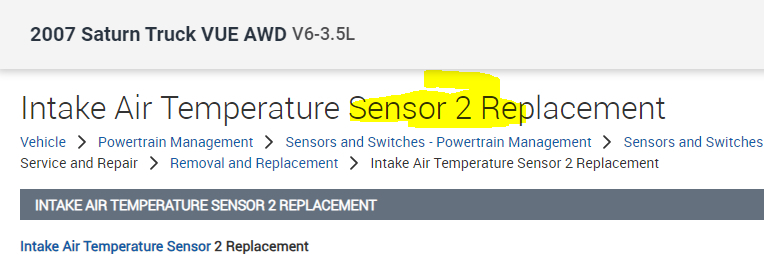

Confirm that the sensor you have is the same as the one I circled below. I believe that is the second one. It's hard to orient myself with the pic.
See pic below.
Sep 5, 2024 at 7:05 PM
SHERILYN FRANKLIN
  • 90 POSTS
Is that the AIT sensor? The one I have is identical to the mass air flow sensor under the air filter.
Sep 5, 2024 at 9:29 PM
Based on what the manual is showing me, I believe it is the IAT. Take a look at the attached picture below. The manual identifies that as IAT 2. It also identifies the one in the air box as IAT 1. It should be right behind the throttle body.
Sep 6, 2024 at 7:55 PM

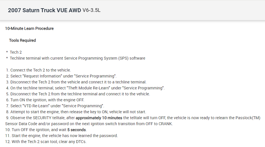

I installed the IAT sensor and did a scan it didn't detect any error but the dash still has the error code. And I would like to know if I can use a scan tool to program my key fob.

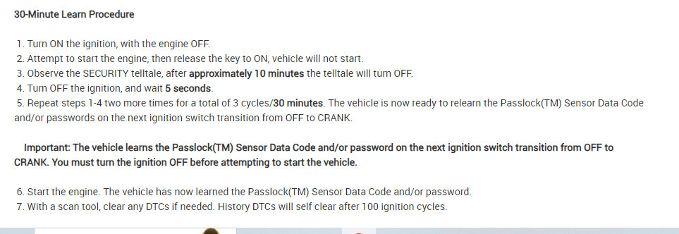

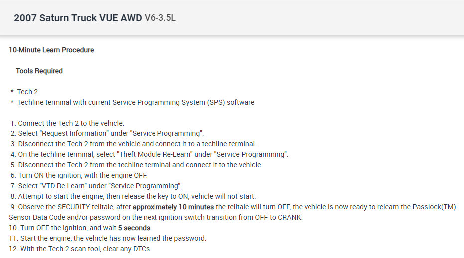

Sep 18, 2024 at 9:12 PM
The scanner really isn't needed for a relearn related to the key fob. Also, I'm not sure if you have a bi-directional scanner that can communicate in both directions.
As far as the relearn, you can use a scan tool or you can do it without the scan tool. I attached directions below for both procedures.
Let me know if this helps.
See pics below.
