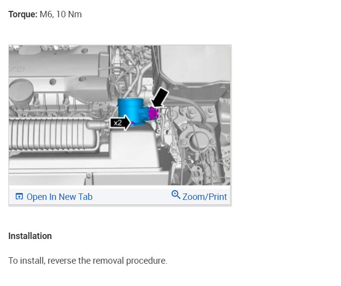

I am trying to find the location of the Mass Air Flow Sensor on the vehicle listed above (t5).

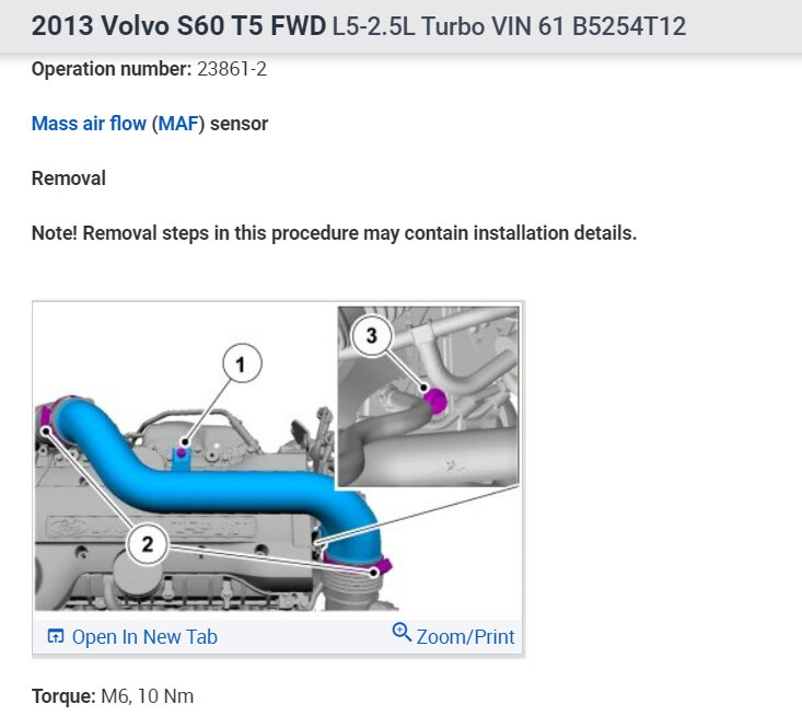

Sure, it looks like the MAF sensor in the air intake tube of the engine here is the location and how to change it out. Check out the images (below). Please let us know if you need anything else to get the problem fixed.
