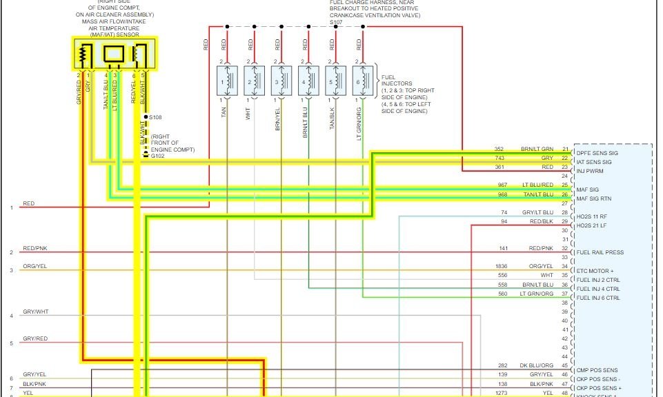

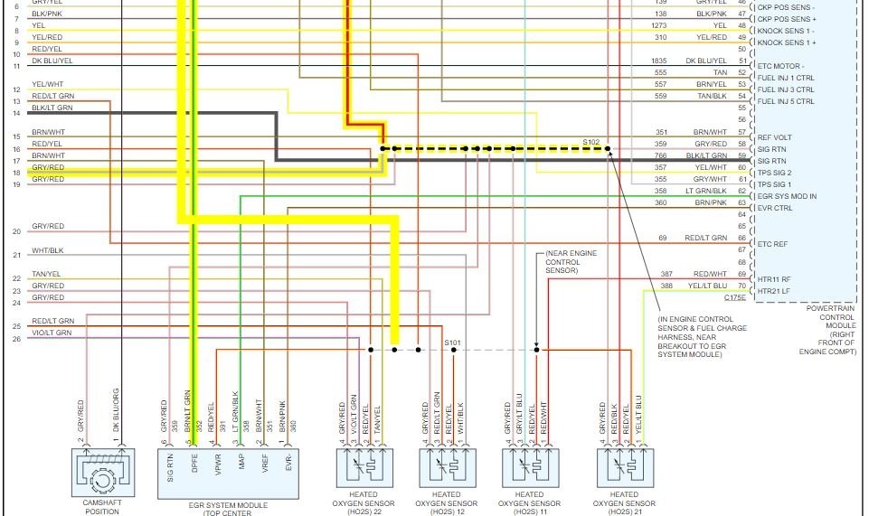

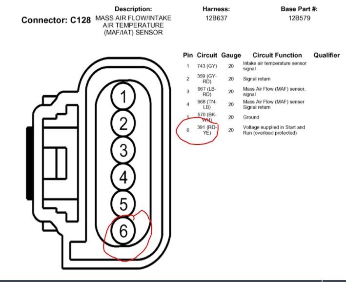

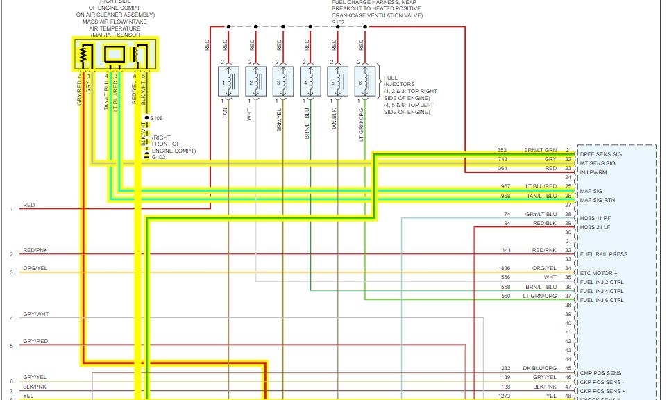

My mass air flow sensor isn't receiving any power. I bought a new sensor thinking it was the issue but then the issue was still there. so I checked if any power was even being sent from the connector to the sensor and nothing.
