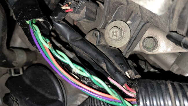

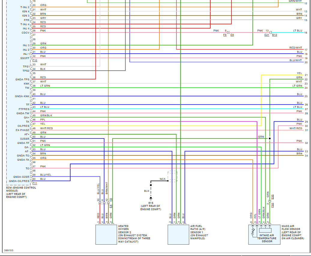

I have a p0100 reading from Bluedriver diagnostic tool. I replaced MAF still have bad code. I realized 1year ago a rat had eaten away at the lt/grn wire leading to MAF. I did check power at the harness and that wire has less volts than the rest. Can this be the issue obd bad code? If so, how to i fix the wire with solder or splice it what type of wire?
