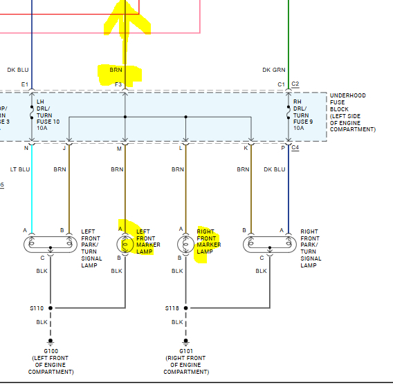

Purchased a used 2004 Forest River Sunseeker 2600 all lights are working except for the marker lights - unable to locate correct fuse

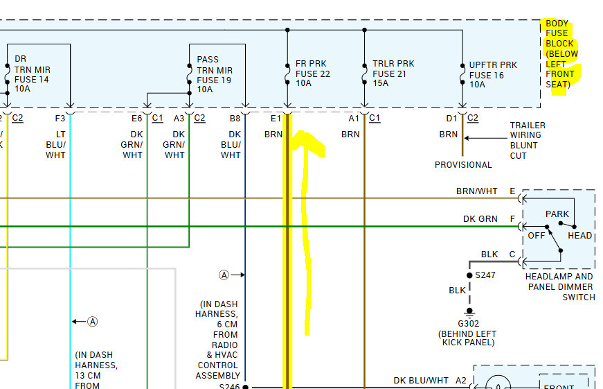

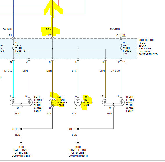

I'm not familiar with the body on this. I suspect it has at least a 2500 GM chassis under it. I attached a couple pics below showing what I found. Take a look at them and let me know if they help.
If not, let me know if it is a 2500 or 3500 chassis and the engine size.
See pics below
