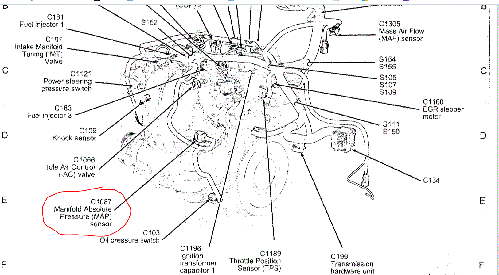

I need the location and the best way to test it. Thanks!

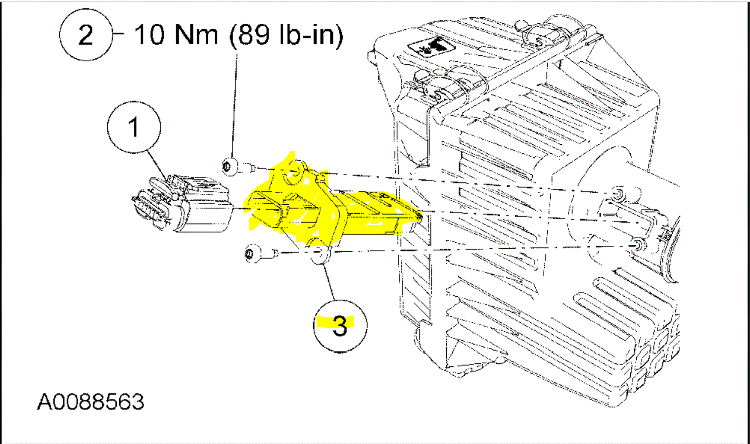

The MAF is on the air filter box right where the air induction tube between the air box and throttle begins. See pic 1 for location.

Here is a link that shows in general how one is replaced. There will be two screws that hold it in place.
https://www.2carpros.com/articles/how-to-replace-a-mass-air-flow-sensor-maf

We replaced the MAF already. Looking for the MAP location. It's throwing the code P0068 and we've checked everything else. Thanks
Jul 18, 2020 at 9:07 PM
Sorry about that. It has been a long day. I attached a pic of the MAP sensor's location. Let me know if this helps.
