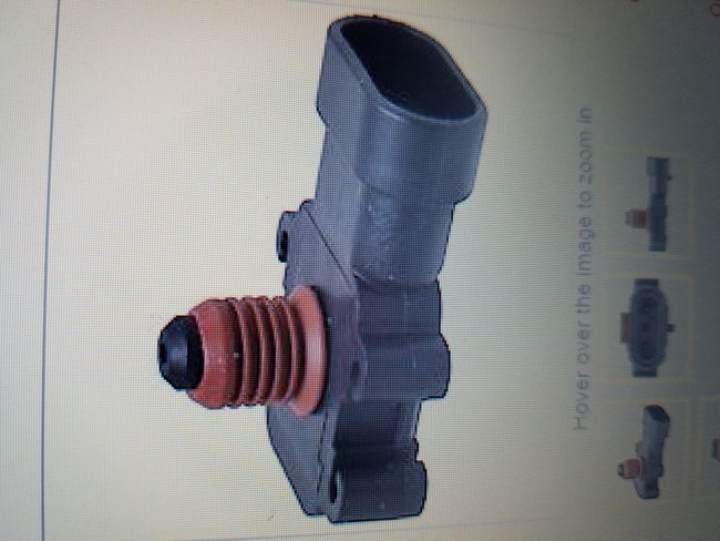

My MAP sensor nipple on bottom of sensor broke off and fell in. Do I need to take top of intake off or does one of the plastic top circular pieces unscrew? The round plastic piece that the MAP sensor, does that piece unscrew or pop off? Please tell an easier way.

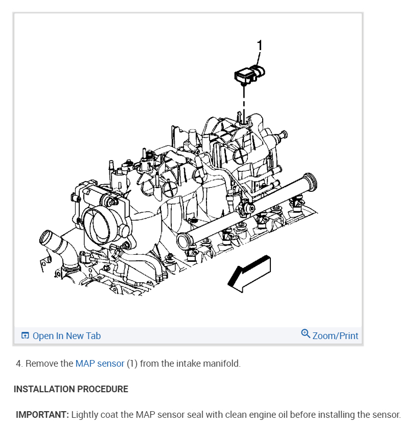

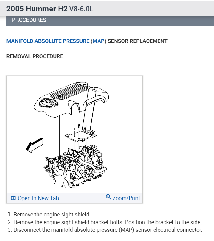

if it fell in to intake and it is not there then do not worry about it it will go through engine and not do much harm if any as it is plastic anyhow. just replace the map and if it has a rubber gasket replace that as well if it does not come with it. Here is the location of the sensor in case someone needs it. Check out the diagrams (Below). Please let us know if you need anything else to get the problem fixed.

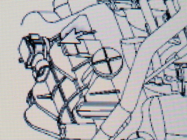

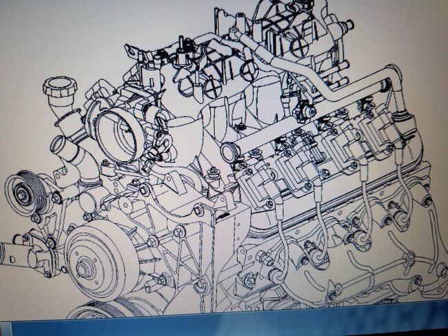

In jut fell in top. I havent started vehicle. Im no to sure about it jus going through system... it was the nipple off the sensor. What happens if it gets into combustion chamber? Or elsewhere. Is there any other way to get it out without taking off intake top. These are pictures of motor and map sensor location.
