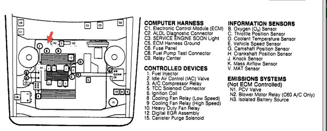

Cannot find the map sensor. need help.
Jul 17, 2017 at 6:13 PM
HMAC300
  • 48,601 POSTS
Picture is not really good, but it is by blower motor in center of dash. there will be a vacuum line going to it. While at it replace the vacuum line as well as due to age it may be sucking together not making map sensor work.
