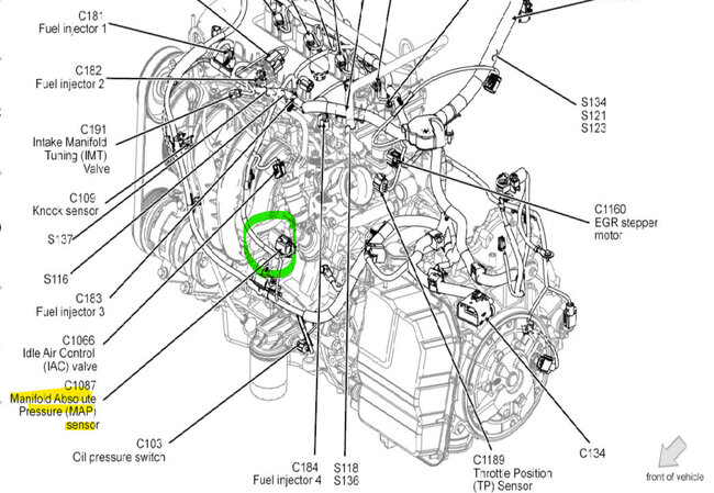

Can you tell me where it's located?
Sorry, I was wrong with the last question. It's a MAP Sensor.
Thank you so much!
May 18, 2023 at 7:06 AM
AL514
  • 5,465 POSTS
Hello, are you getting a code for the MAP sensor? It's located just above the oil filter and will be pushed into the Intake manifold, I'll put a diagram showing it, but it reads manifold pressure. If you're getting a specific code for it, the wiring will need to be checked. This vehicle is not a Hybrid is it?

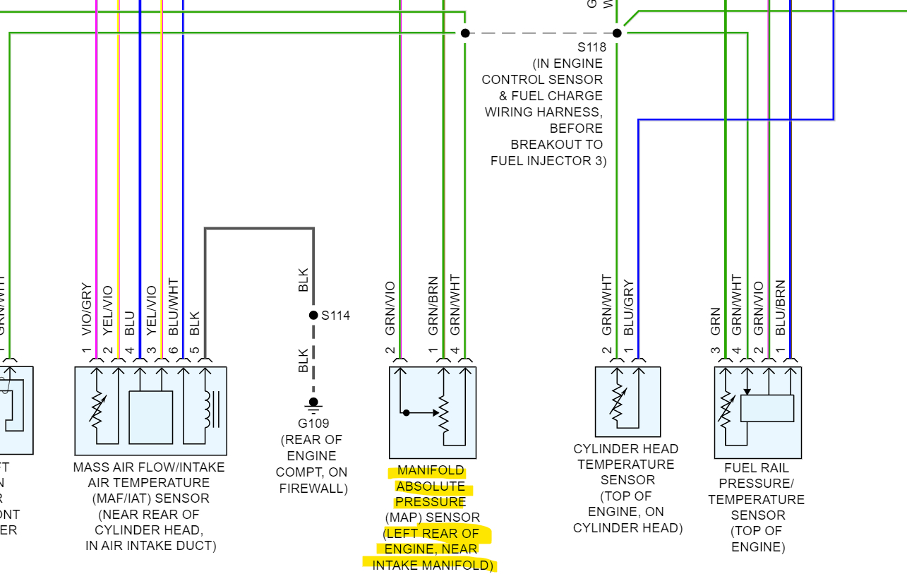

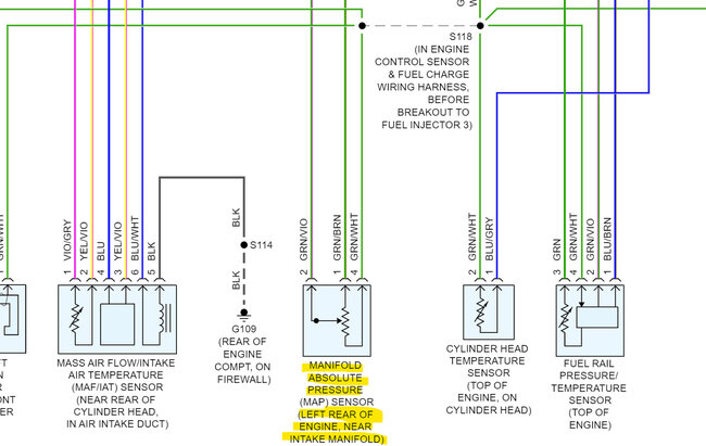

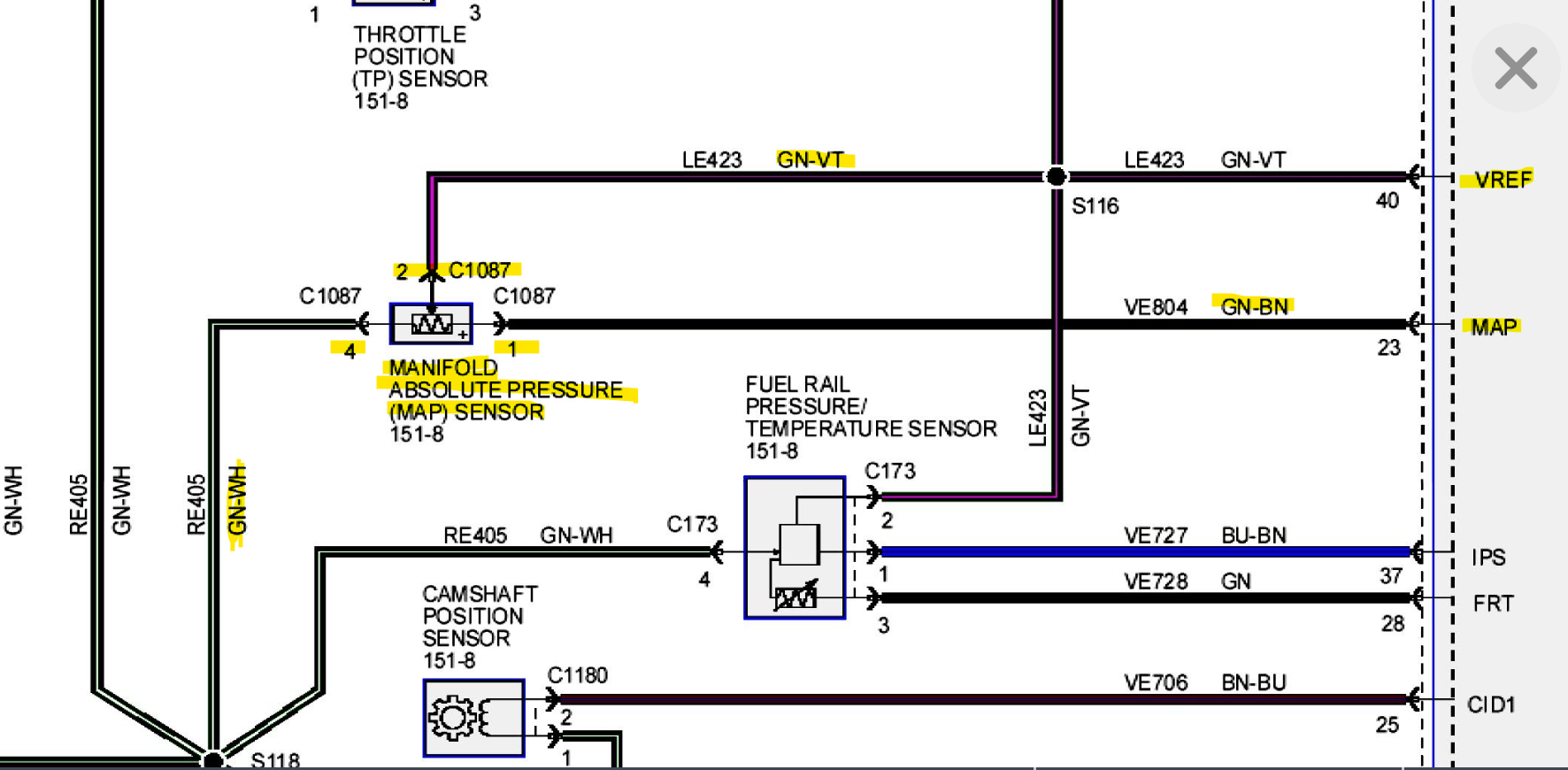

Both diagrams 2 and 3 show the wiring colors for the MAP sensor connector. The Green wire with a Violet stripe is the 5-volt feed, the green/brown wire is the Signal wire to the engine computer, and the green/white wire is the sensor Ground.
