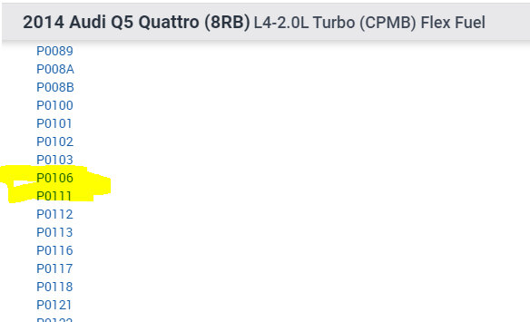

Vehicle listed above TFSI (Petrol) 2.0 with CNCD Engine.

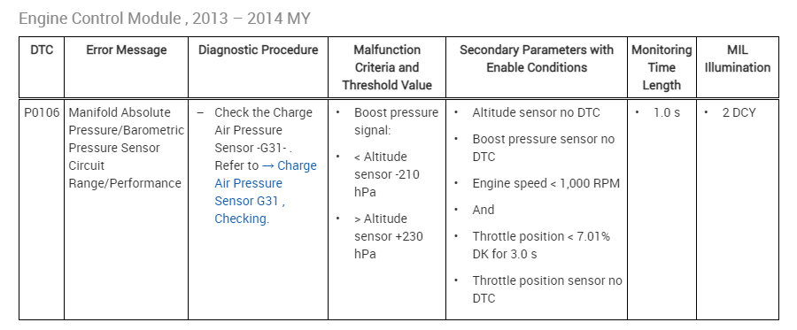

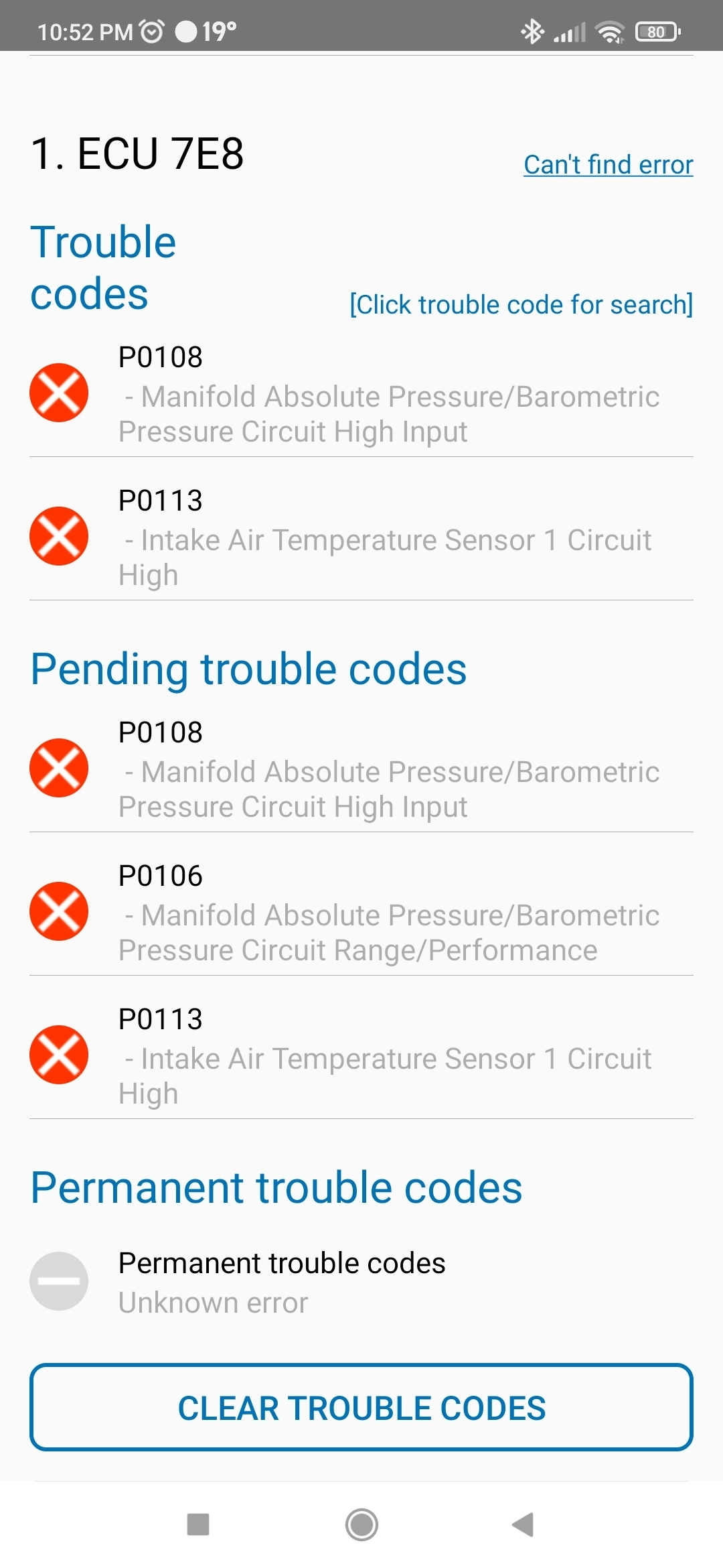

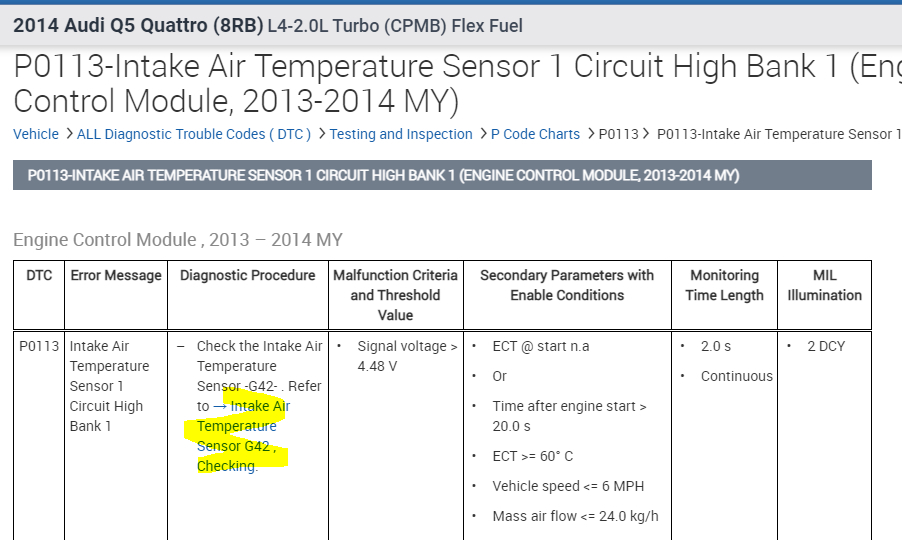

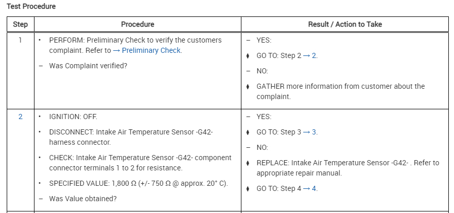

Check light randomly comes on. OBD Scan Tool found the following errors:
P0106, P0108, P0113
These are related to Intake Air Temperature Sensor and Manifold Absolute Pressure sensor
I need help for finding the exact part number and location of the two sensors.
P0106, P0108, P0113
