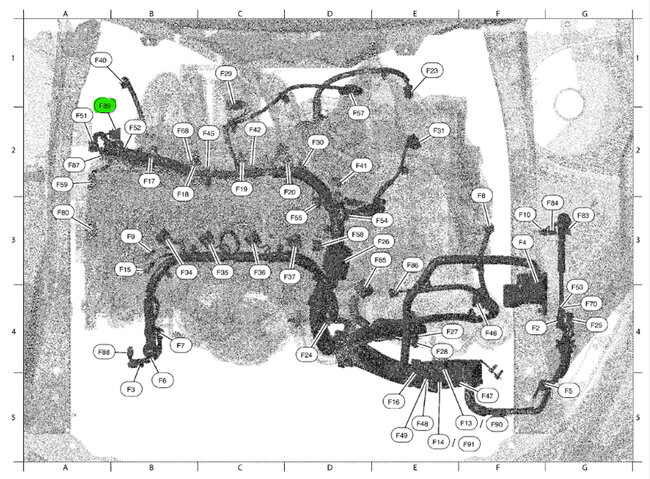

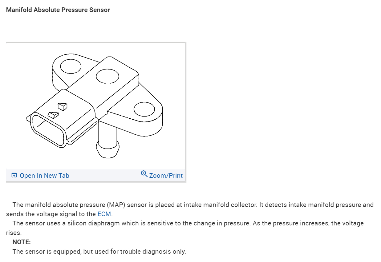

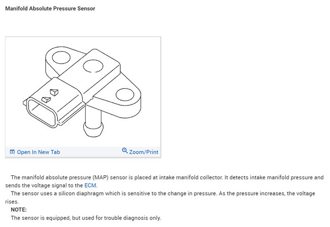

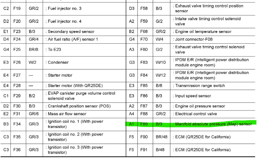

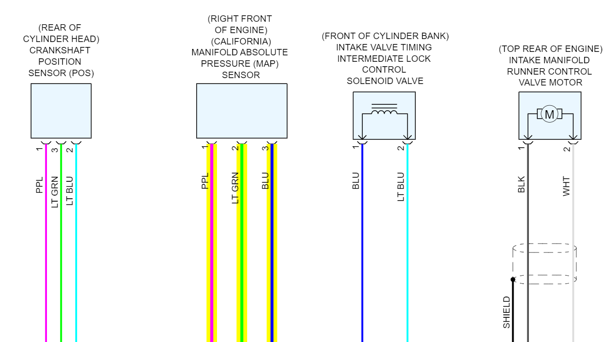

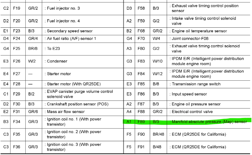

If you do have a Map sensor on this vehicle it is only used for diagnostic purposes, it has no control over fuel strategy. It reads Intake manifold absolute pressure, so there might be a vacuum leak somewhere causing this code. But here is where it is supposed to be located. Nissan is terrible with their diagrams. The second is engine compartment. In the first diagram it shows the colors of the wires going to the map sensor. It will be located somewhere after the throttle plates/Throttle body on the intake manifold.
