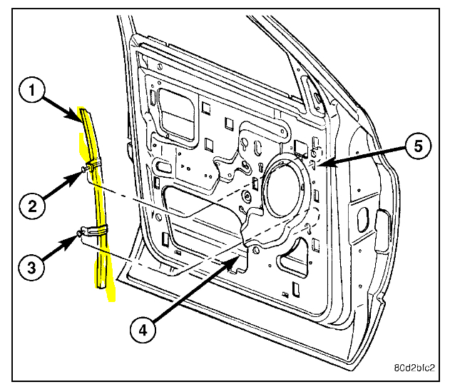

I replaced the door latch today, and everything went okay. I had to move the window channel out of the way a tiny bit, so I unbolted one bolt (it doesn't have two on the side of the door and the Alldata didn't mention it, but there was no way to get it out without moving it) and moved it slightly out of the way.
Everything went back together, but it seemed as though it met resistance, and the window doesn't move now. It just seems to be stuck. They are manual crank windows.
Is it possible that the window came off the track, and what would the best way to figure that out be to at least get the window back up and stay up for now?

Are you able to turn the handle or does it seem stuck as well? If you loosen (not remove) the bolts holding the track in place, can you close the window?

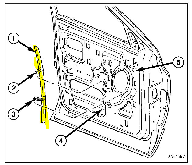

I attached a pic below. Is that what you had to move?
See pic below.
