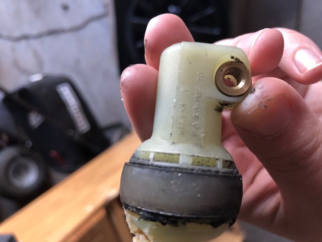

What is this part called? I ordered a rebuilding kit for my shifter and it did not include this piece, it was attached on the shifter.

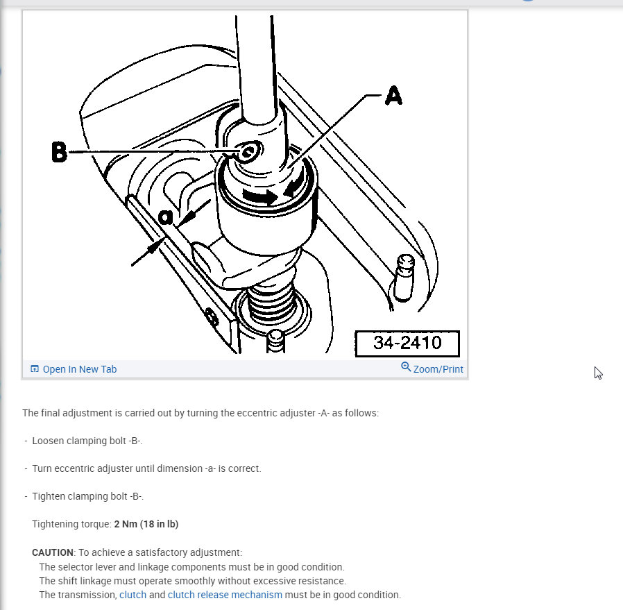

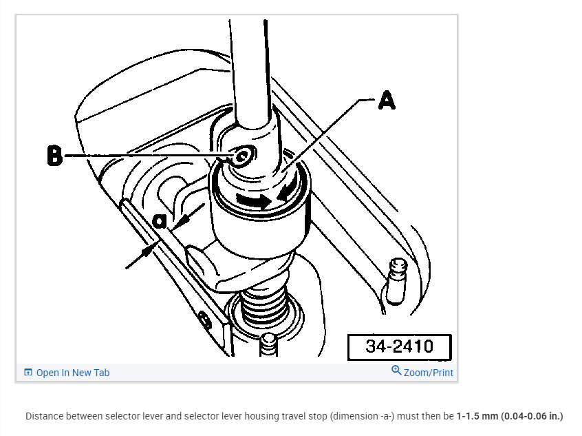

It appears they call this the selector lever housing. I attached the info about inspecting this and taking a measurement during a rebuild.
Let me know if you need more info.
