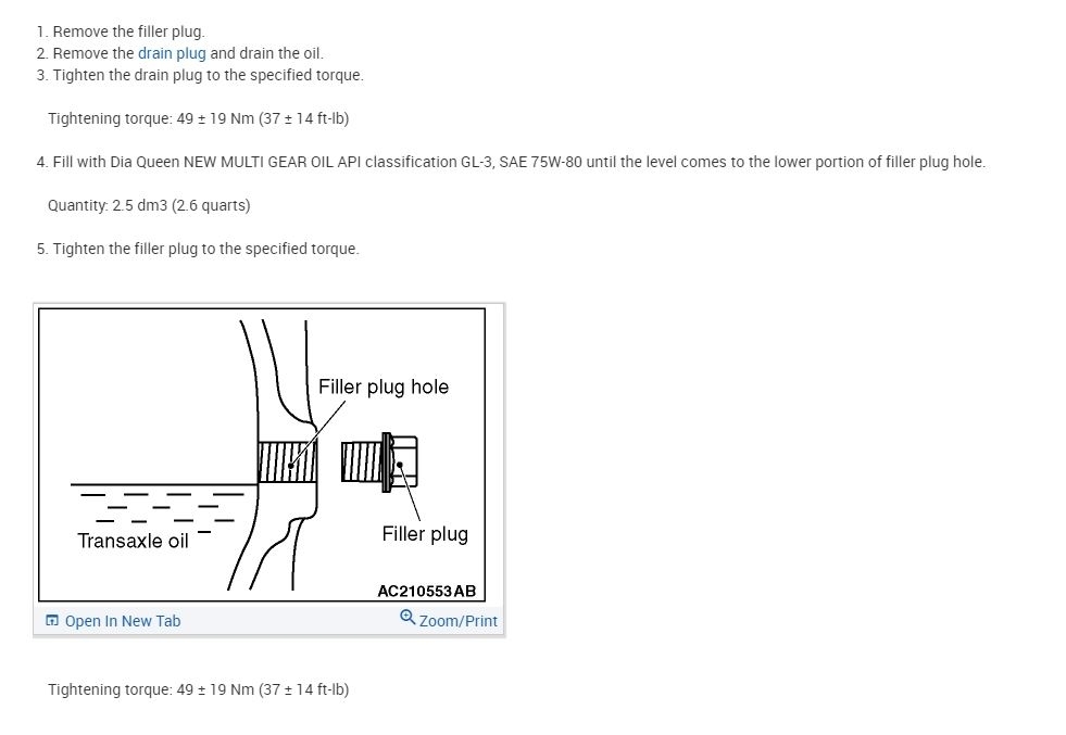

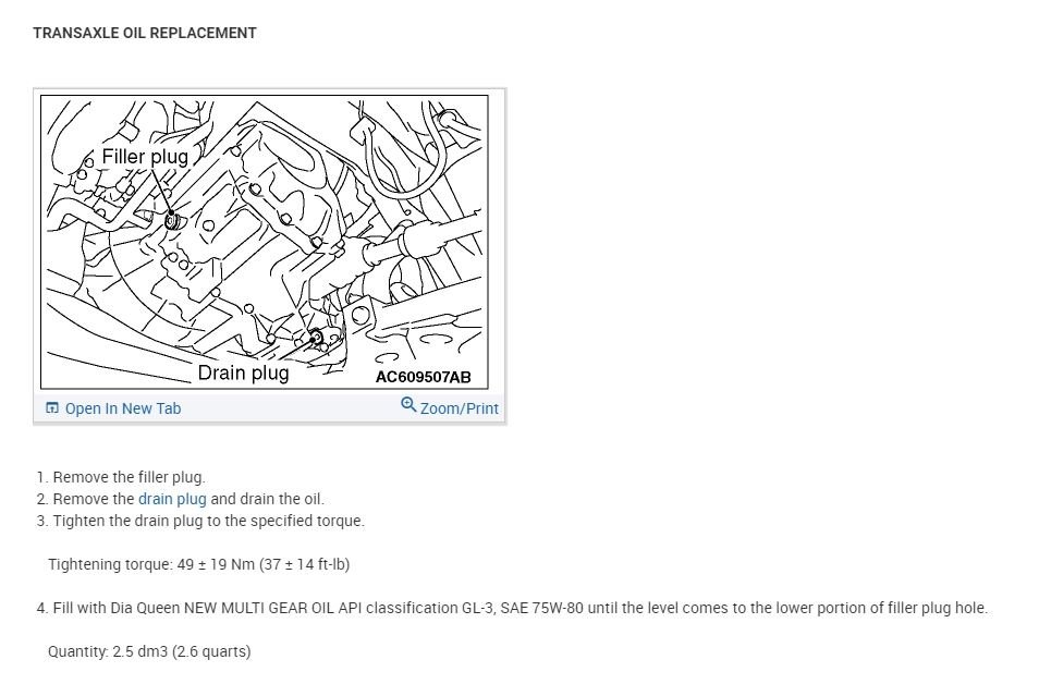

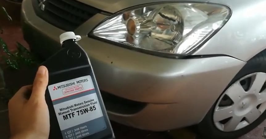

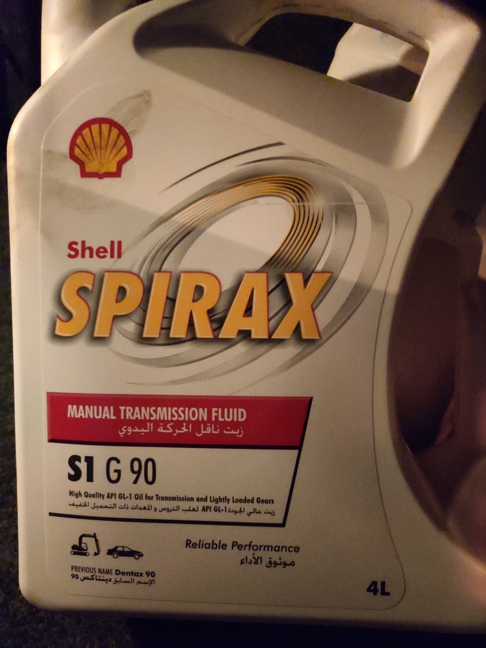

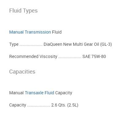

Dear Roy, I saw your attached files regarding my car and found out that I put on my car the wrong gear oil so, I guess it's why my transmission is doing this kind of issue.
instead of "75W-80 Gear + GL-3" oil type, I put on "SI G-90" from Shell CO.
I called in my Local Mitsubishi Motors Co. regarding the issue, they said this oil you want, you might not find it around here (in my country).
Please Roy, check the attached video and photos as you requested so.
From the video you could just realize that the transmission is stuck/cannot change to the other gear.
