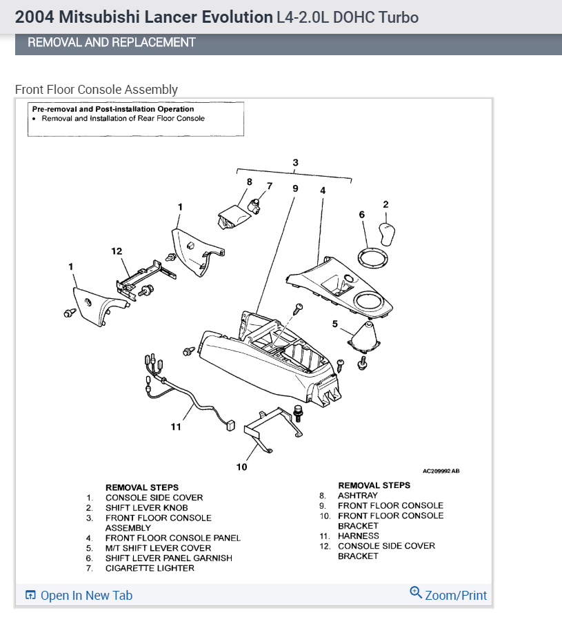

I’m trying to change out manual boot for a new one but I can’t find any thing on this specific lance OZ Rally model.
Jan 1, 2020 at 1:51 PM

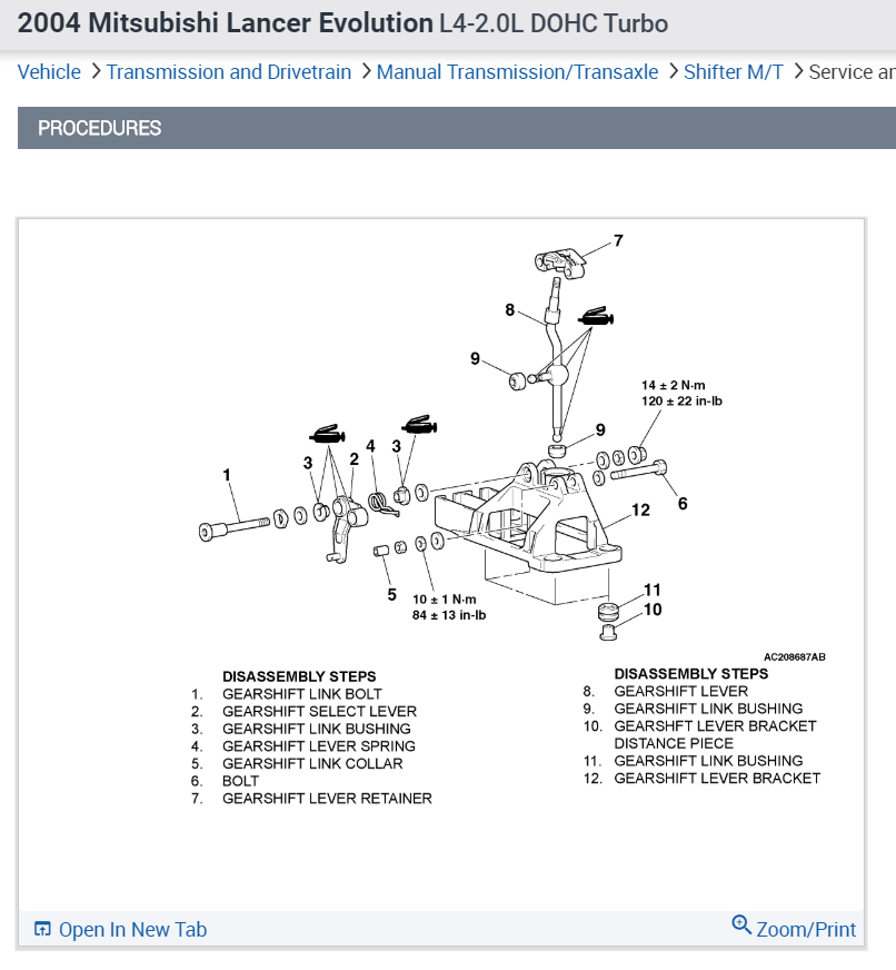

Here are the instructions in the diagrams below on how to replace the shifter boot. Check out the diagrams (below). Please let us know if you need anything else to get the problem fixed.
