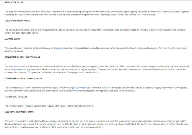

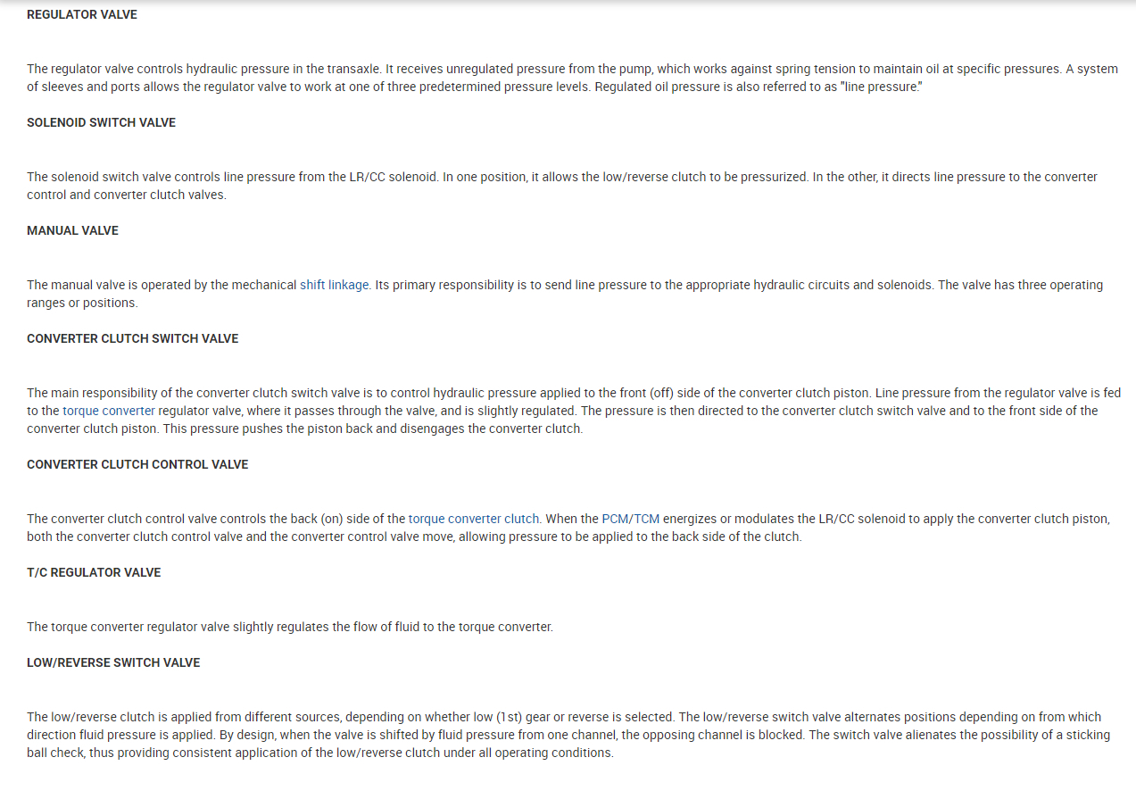

This sounds like a valve body issue in the transmission.
https://www.2carpros.com/articles/automatic-transmission-problems
I would start by changing the fluid and filter and see if it helps. Beyond that may require removal of the valve body and inspection.
