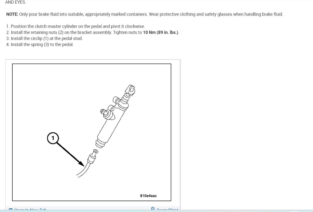

My manual shifter will lock in 6th gear whenever it feels like it. So, I pull over, turn off the vehicle, pump the clutch and gently play with the shifter then it will engage and let me on my way. Have noticed a small leak drivers' side above the exhaust manifold (MC or Slave maybe?) One time had a small oily spot inside the vehicle around the clutch (MC again?)
