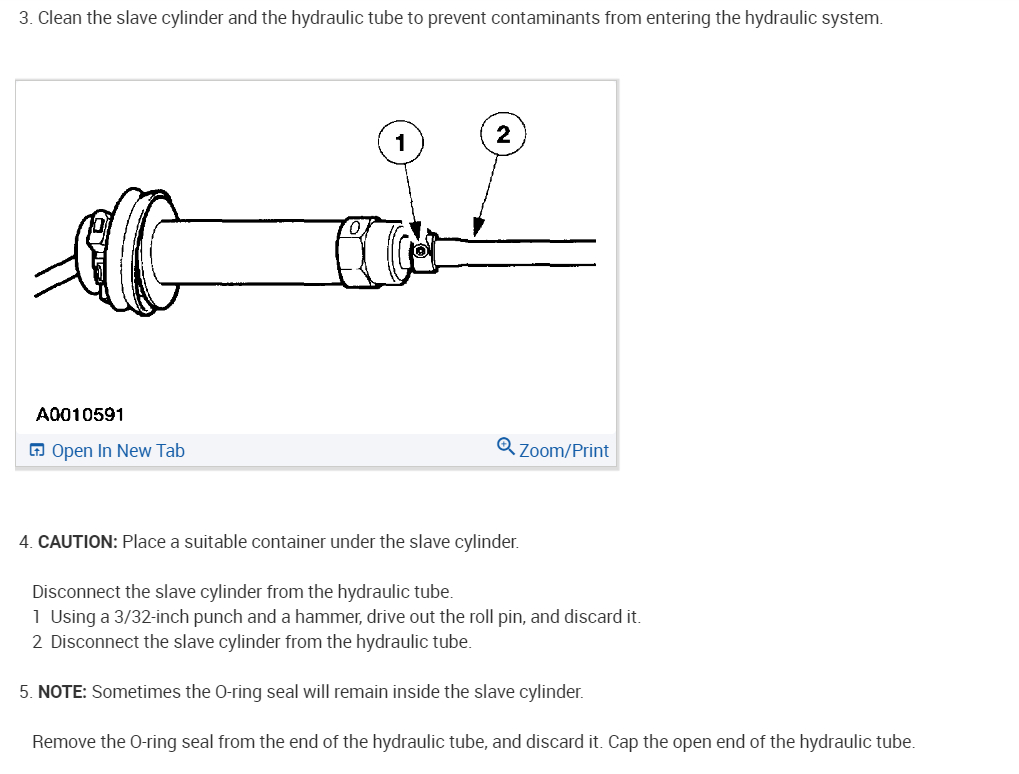

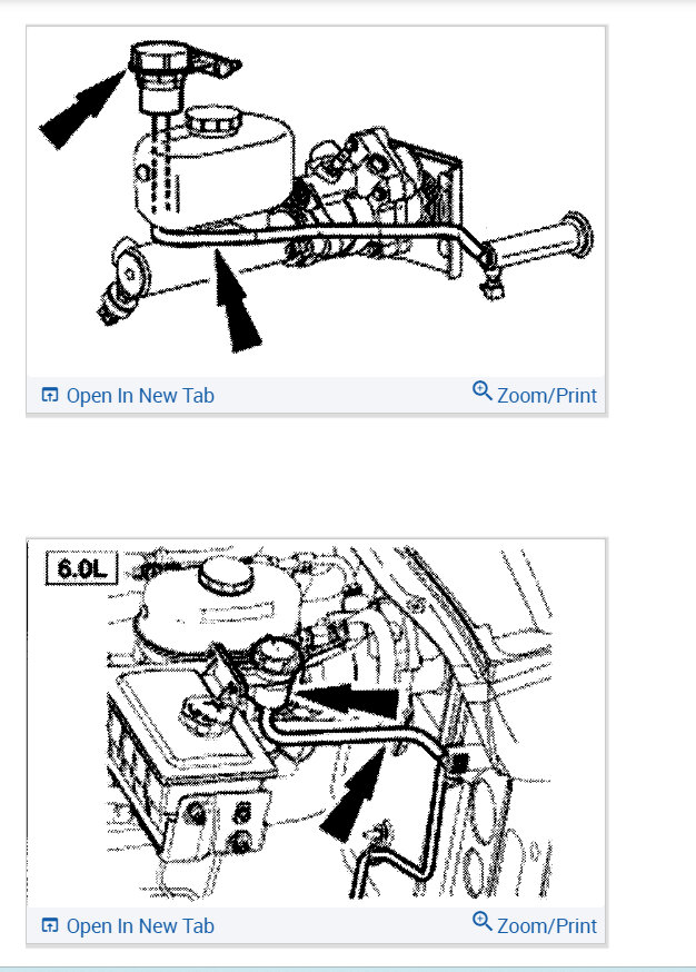

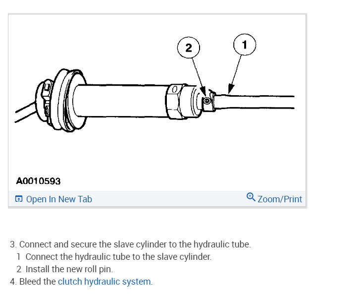

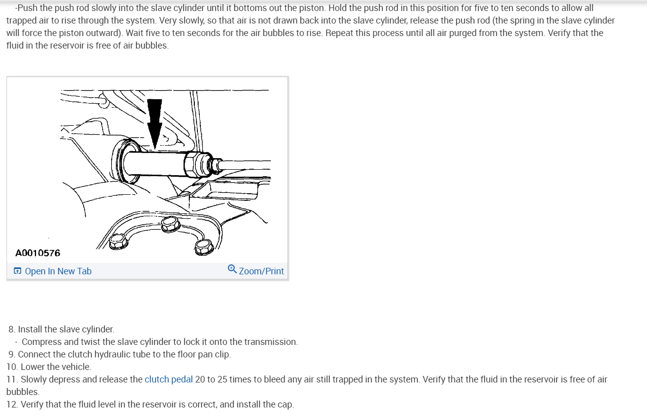

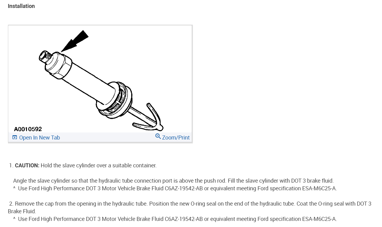

It does have a placement for the clutch secondary cylinder that the push rod needs to fit into. But can I ask if you bled the system once the job was complete? This video might help as well:
https://youtu.be/EpBMj5ZY_bo

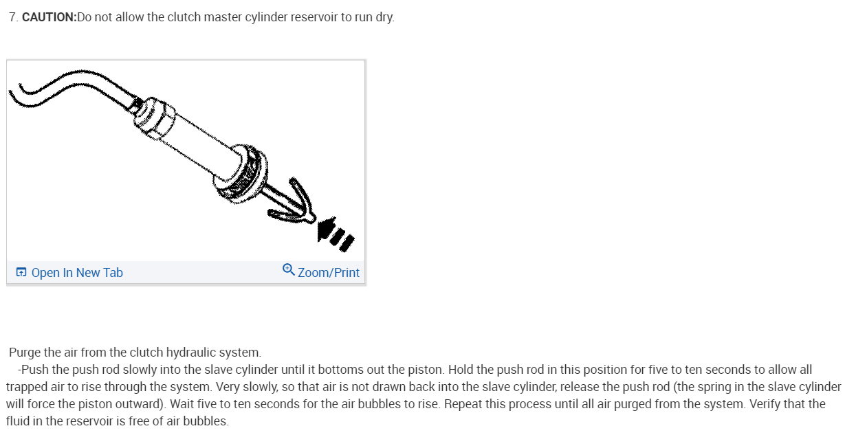

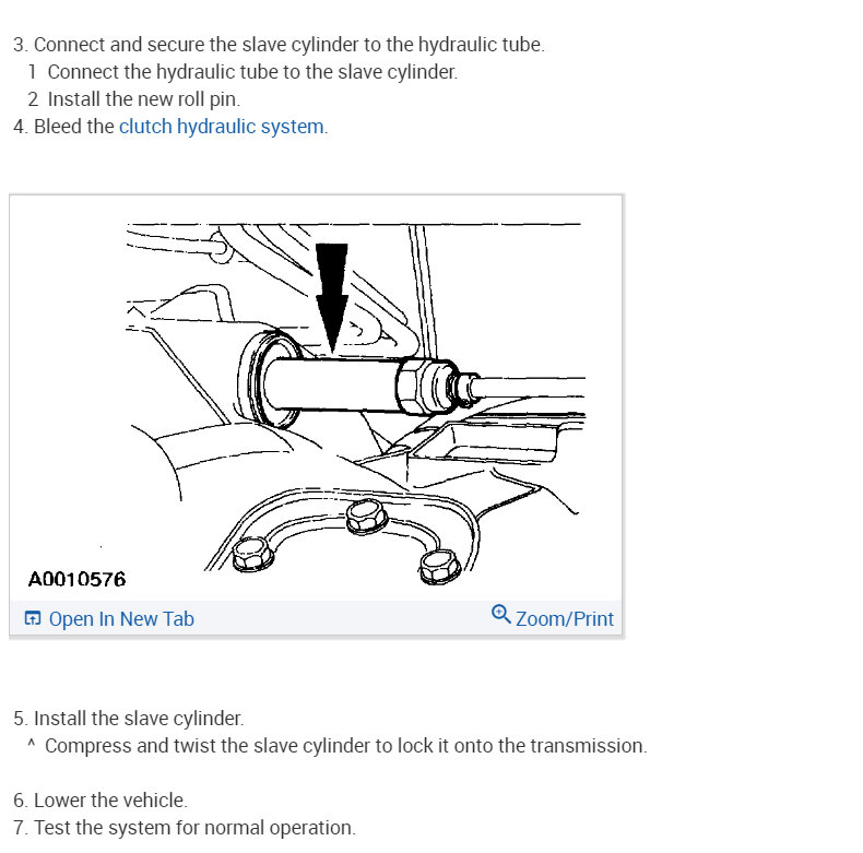

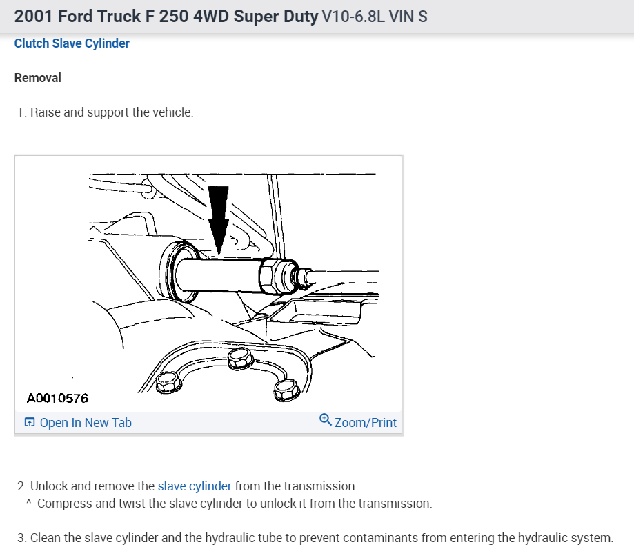

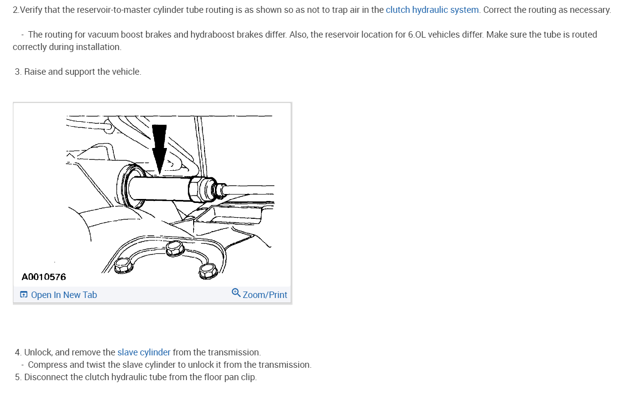

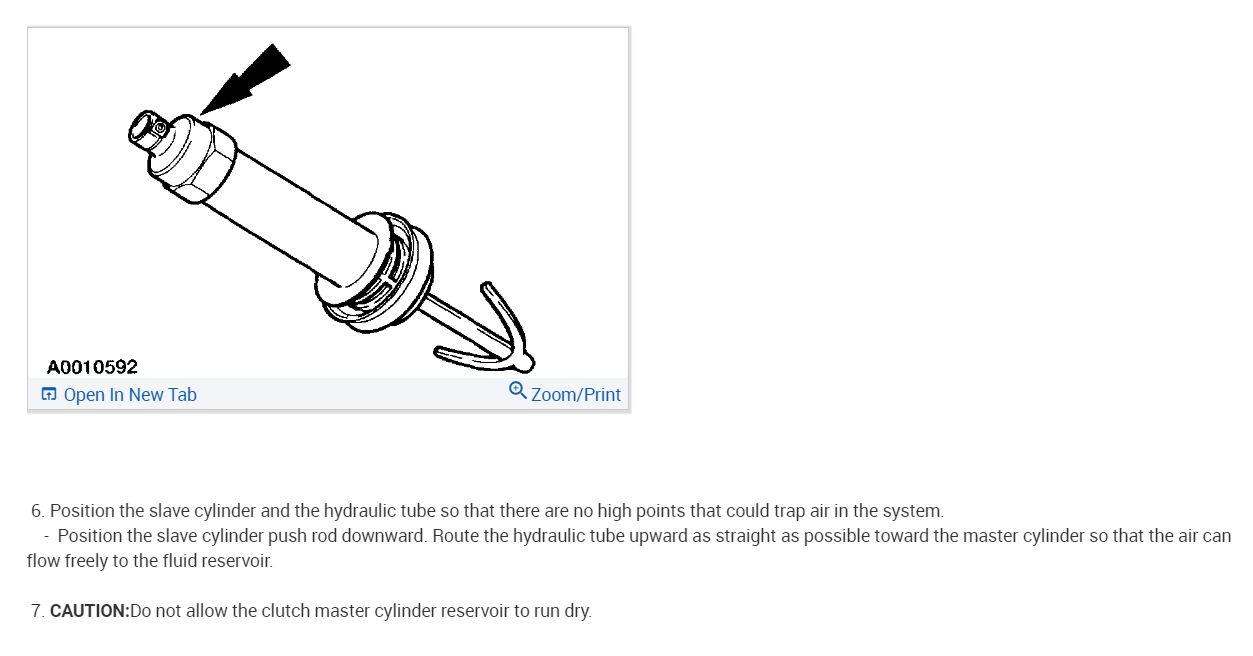

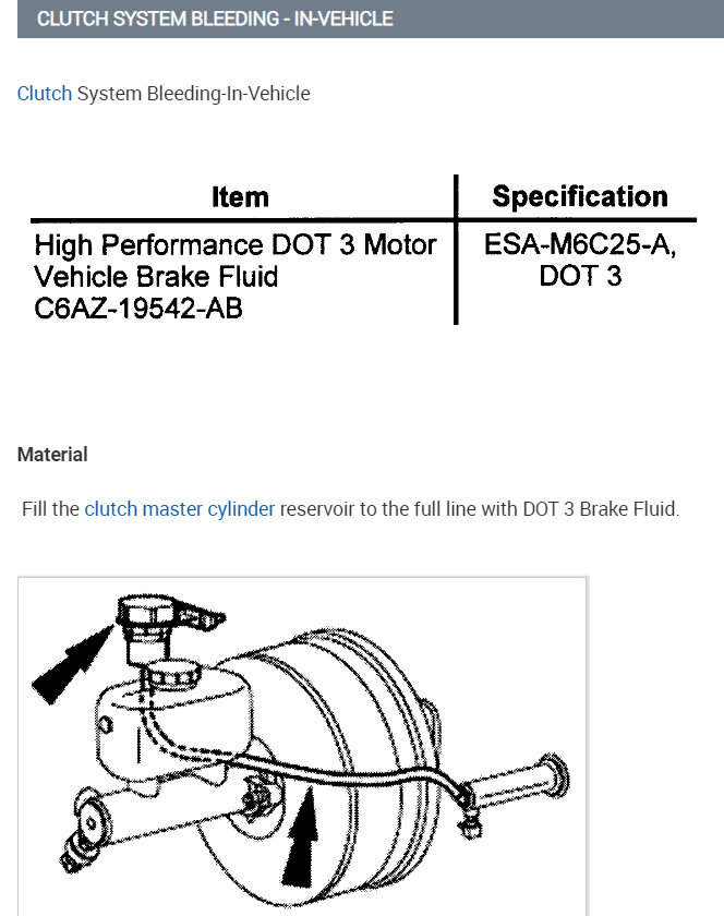

Please check out how the job is done in the images below; it includes how to bleed the clutch system. Check out the images (below). Let us know what happens and please upload pictures or videos of the problem so we can see what's going on.
