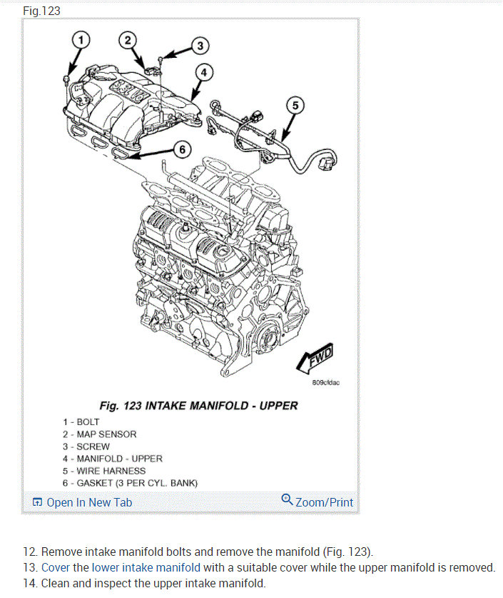

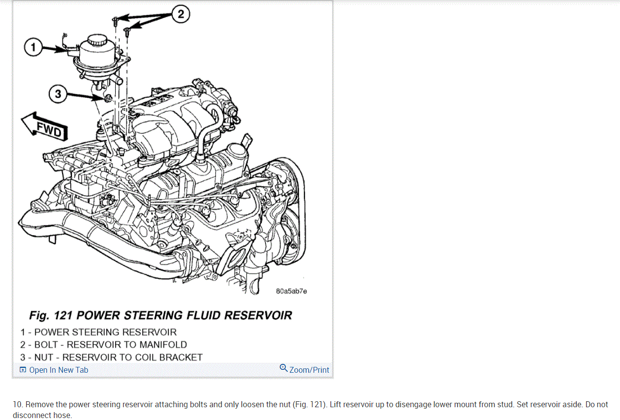

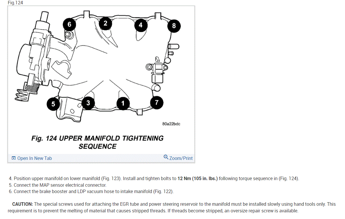

I recently replaced valve cover gaskets and upper intake manifold gasket. I removed fuel injectors from the upper intake to thoroughly clean it. I put everything back together correctly and I have no error codes but my van turns over but won't start. Yesterday I noticed fluid coming out of the down pipe gasket that connects to manifold located in the front. Any ideas on what I can do to fix my issue?
