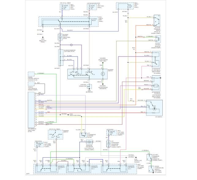

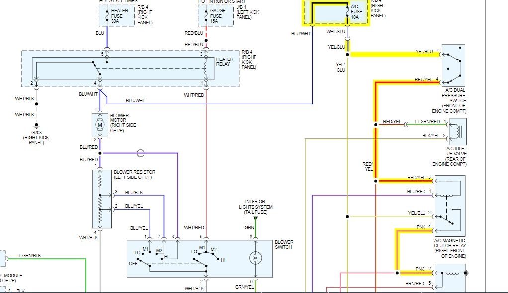

The system was vacuumed and recharged with gas but the fuse behind the glove box was blown so I replaced it. When I turned on the A/C, the clutch engaged but the fan would only blow hot air into the car. After turning the A/C on and off a few times the fuse blew out again.
What items should I check next?
