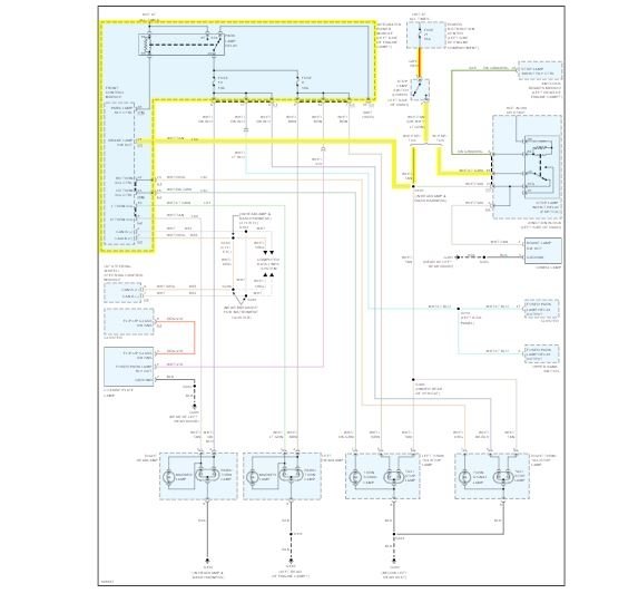

Good afternoon,

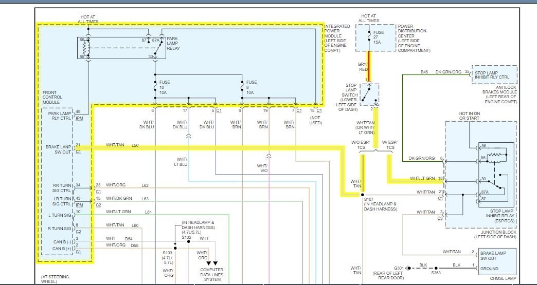

I attached a wiring diagram for you to view. You need to check all the fuse in the under hood fuse block with a test light or voltmeter for power on both side. The fuse block is a common failure but needs to be confirmed.
As far as the airbag light, I need the code that is set for that system. that is a separate issue.

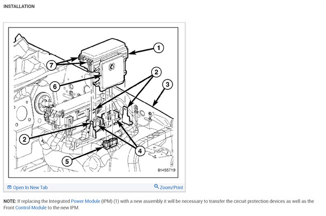

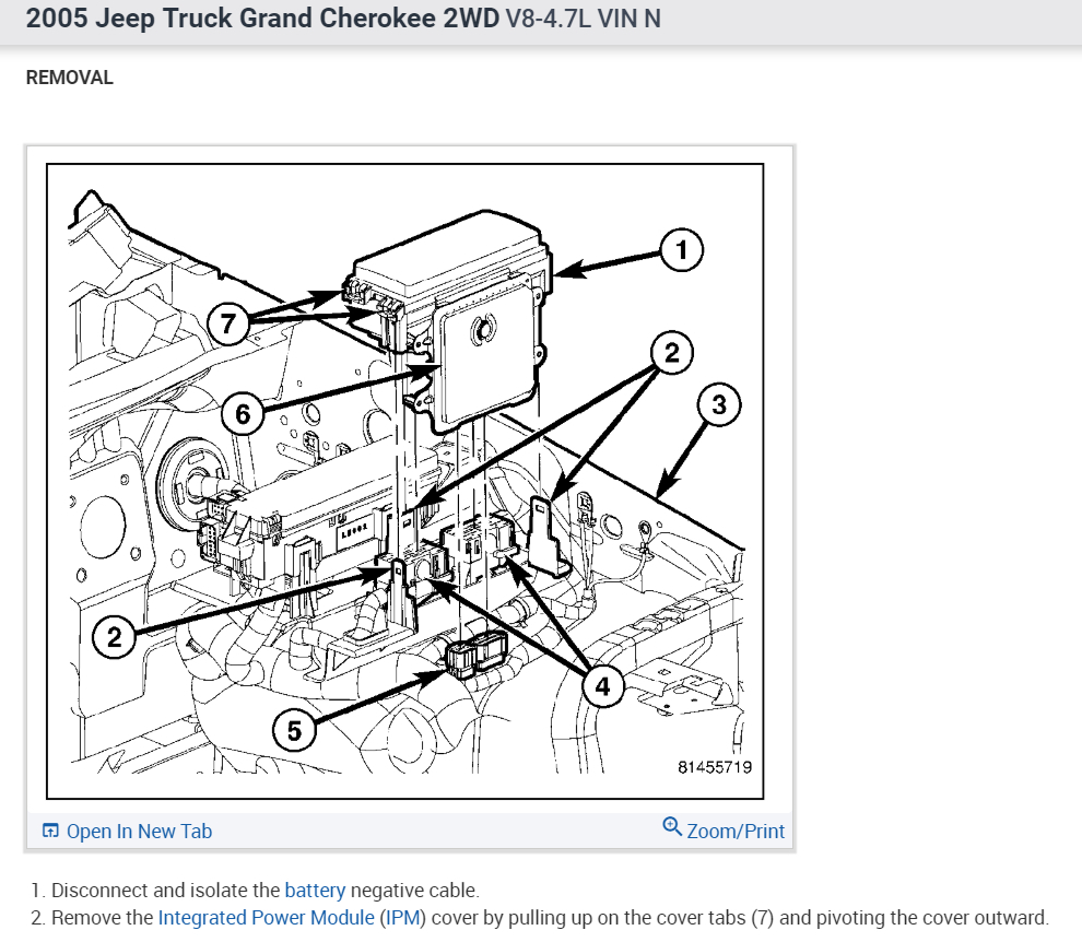

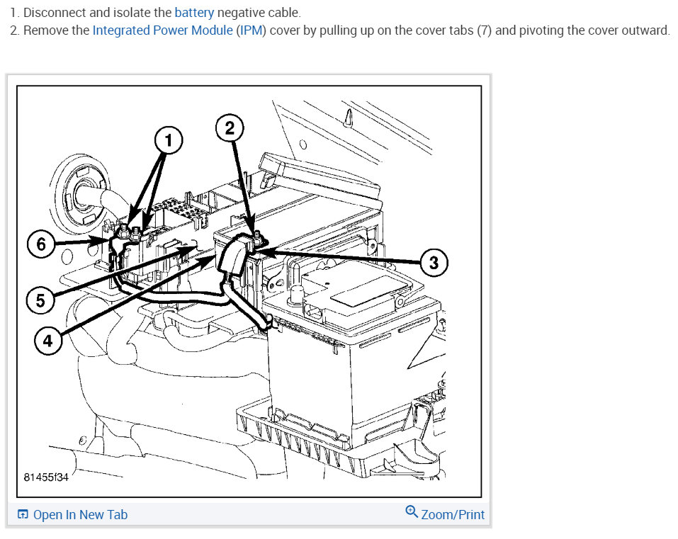

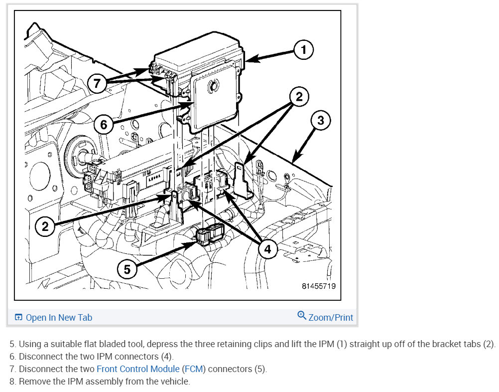

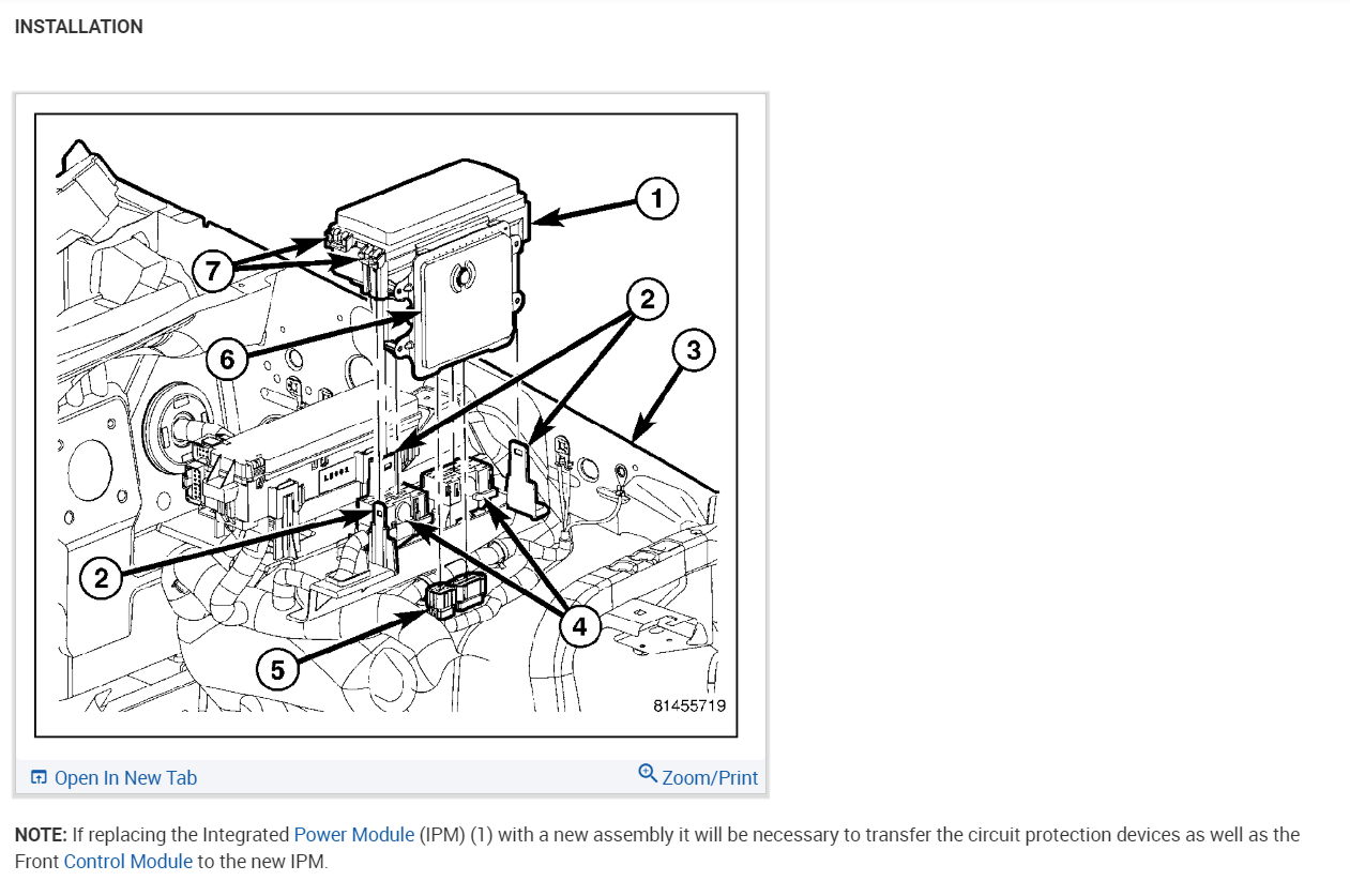

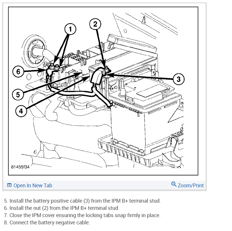

If I can jump in here, it sounds like the TIPM module is out which is common. here are instructions to replace it. It self initializes so replacement is easy. Check out the diagrams (below). Please let us know what happens.
