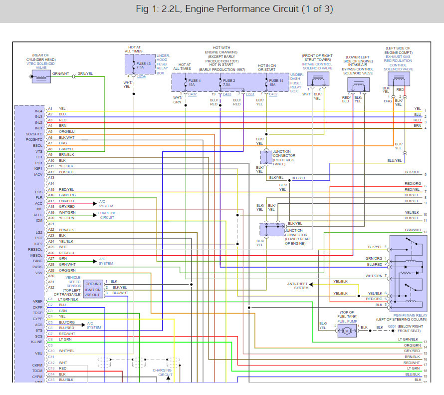

Can I get the main relay wiring diagram?
2000 HONDA PRELUDE
200,000 MILES • 2.2L • 4 CYL • 2WD • MANUAL
DLUDER
H23a 11.5 comp pro1 cams tuned on Hondata.
I had it tuned perfectly, but it started getting lean at times and bucking at cruise. I replaced the entire fuel system, sensors, a lot of wiring, ECU, hondata, distributor, checked tune multiple times, re-tuned, had professional check tune. I think something is causing interference or back-feed to ECU but no Check Engine Light. However, it'll get a solid Check Engine Light with chrome chipped ECU. I'm lost and I need help. Relay wiring diagram would help.
Aug 13, 2022 at 10:12 AM

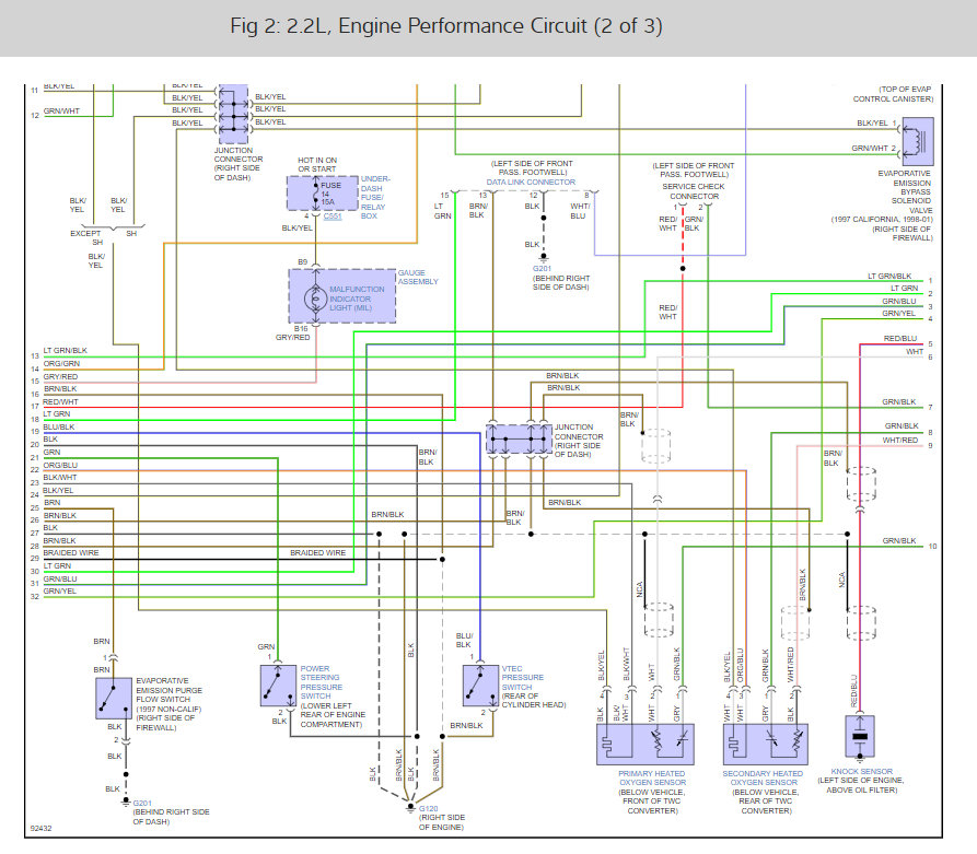

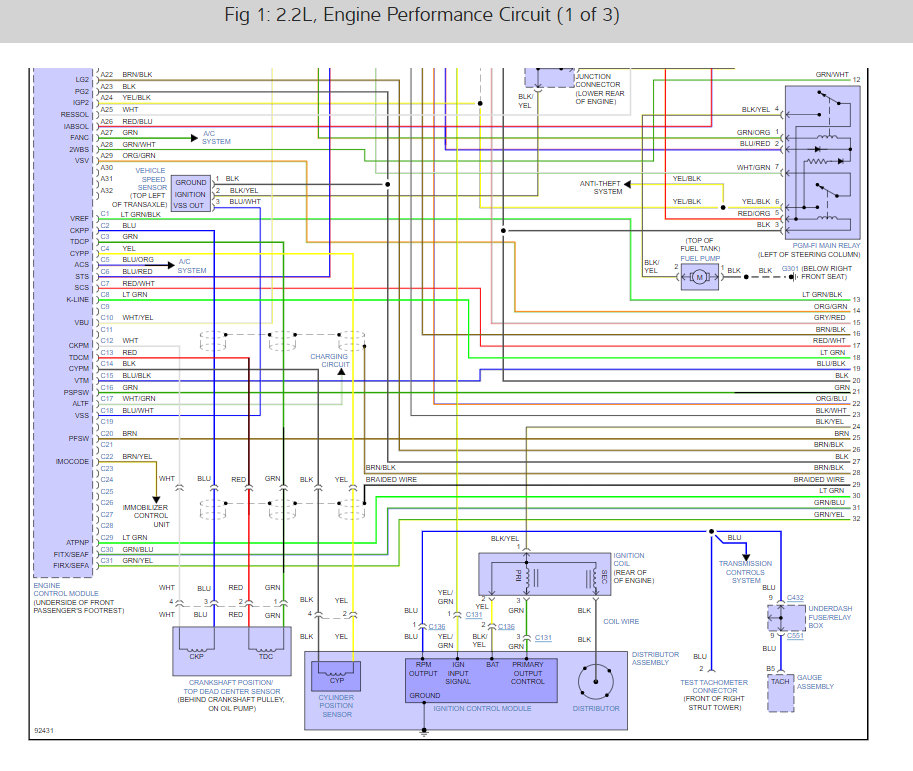

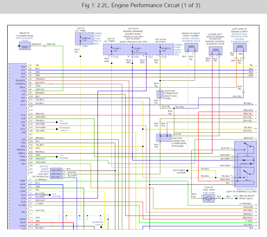

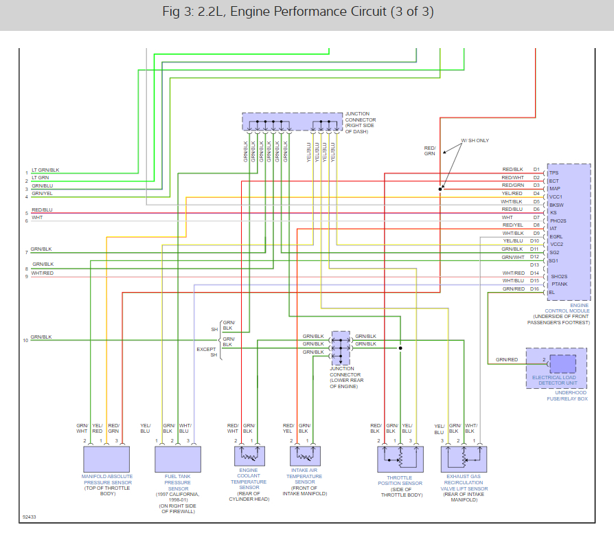

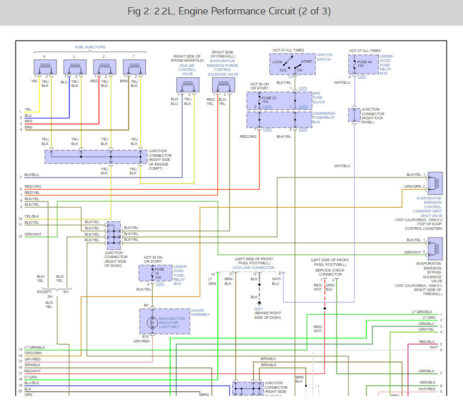

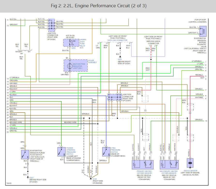

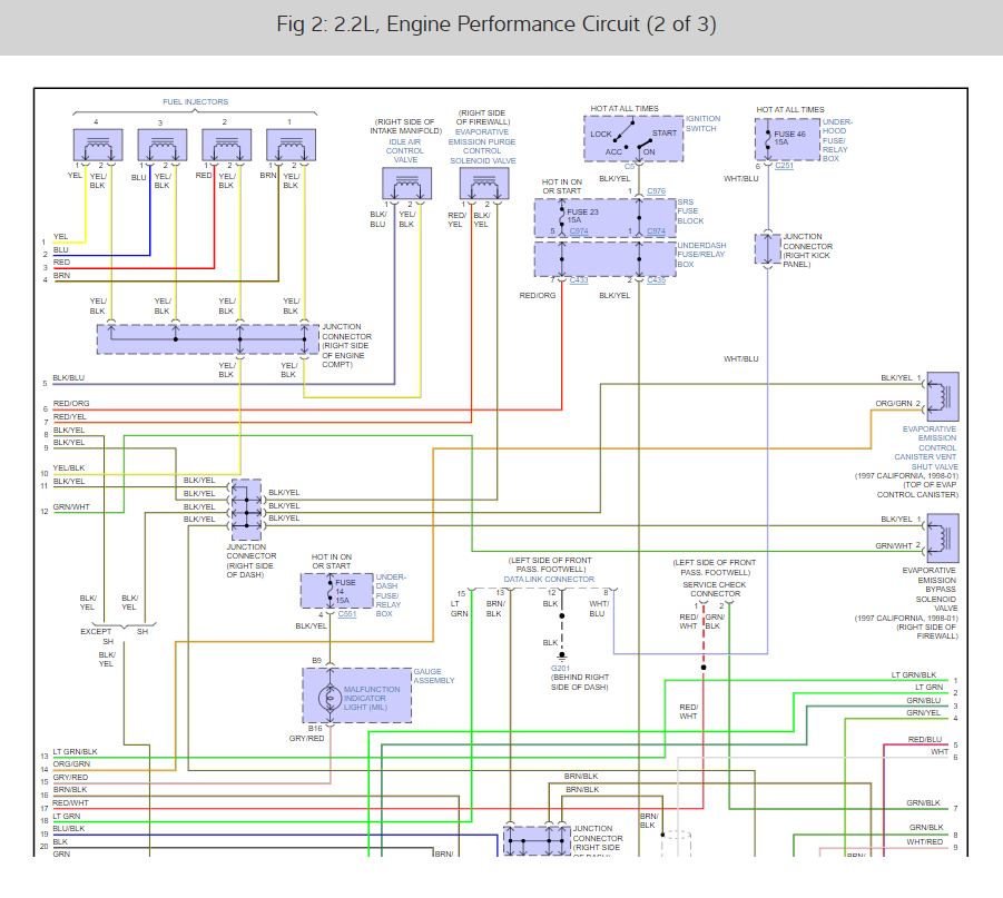

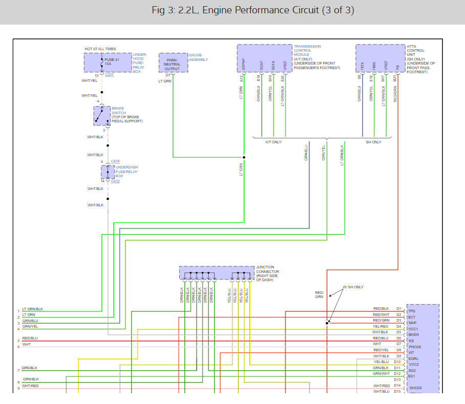

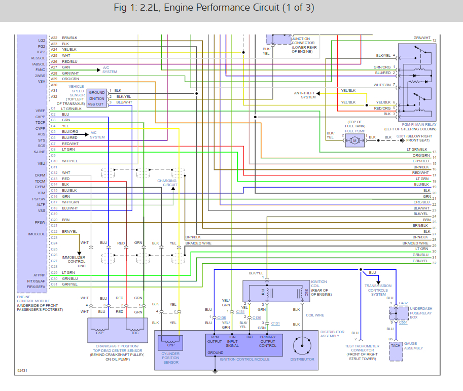

Does the car have any codes? This guide will help you run them also, recheck all engine and body grounds. Here is a guide and the engine with main relay wiring diagrams for your 2000 Honda Prelude in the images below. This guide can help you test the connections.
Check out the diagrams (below). Please let us know if you need anything else to get the problem fixed.
