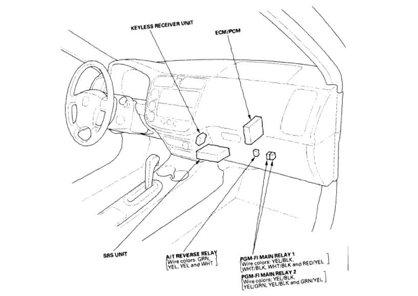

Relay location
Apr 5, 2018 at 3:56 PM
CERTIFIED EXPERT
52,796 POSTS
Good evening.
Under the passenger side of the dash. picture attached. Check out the diagrams (Below). Please let us know if you need anything else to get the problem fixed.
