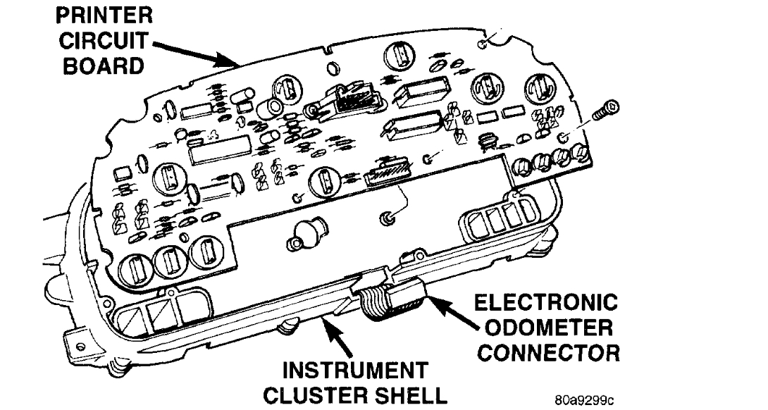

Check the connector behind the dash cluster to be sure the pins are clean and tight and have no damage.
If they are okay, good chance the cluster is bad. The engine control module has no connection to them as it controls fuel controls for the engine.

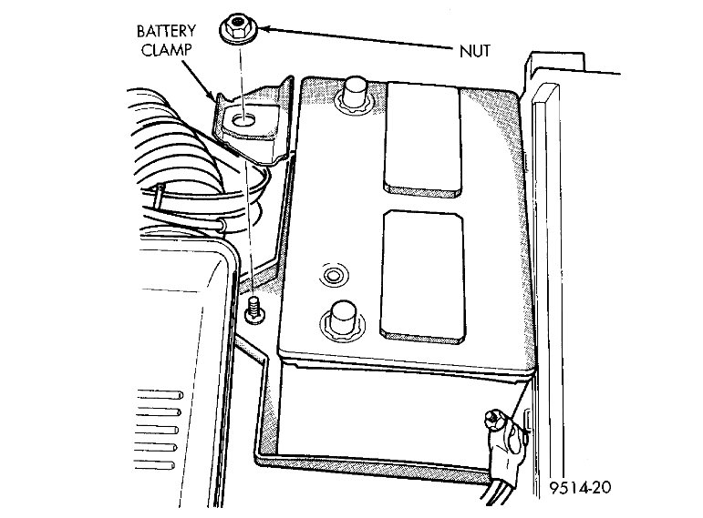

Battery Clamp
imageZoom/Print
4. Remove nut and clamp holding battery to battery tray.
5. Remove battery from vehicle.

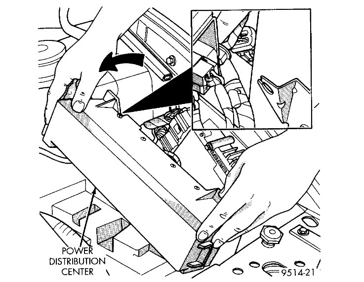

PDC Rear Bracket
imageZoom/Print
6. Rotate PDC toward center of vehicle to remove from rear bracket.
7. Pull PDC rearward to remove from front bracket. Lay PDC aside to allow access to Powertrain Control Module (PCM).

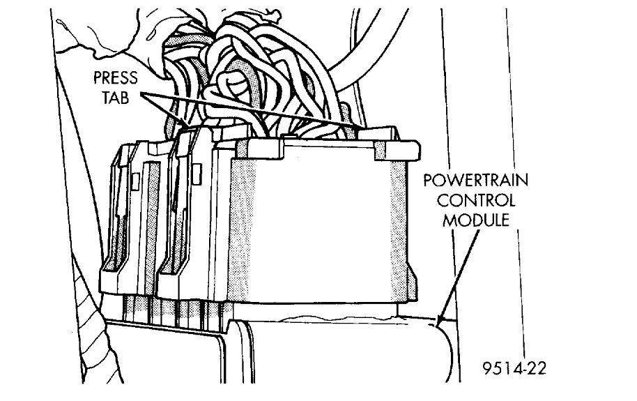

PCM 40-way Connectors
imageZoom/Print
8. Squeeze tabs on 40-way connector. Pull connector rearward to remove from PCM. Remove both way connectors.

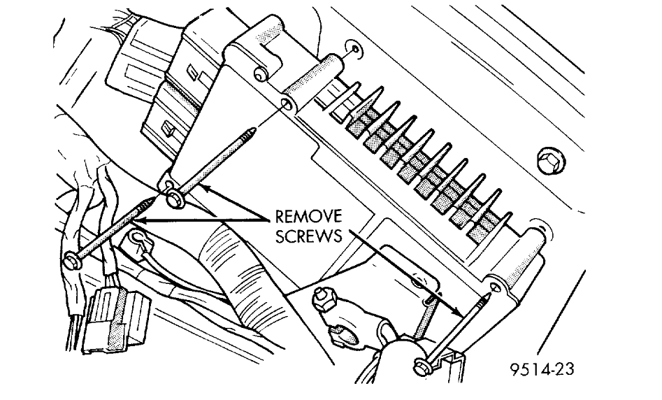

PCM Removal/Installation
imageZoom/Print
9. Remove three screws holding PCM to fender.
10. Remove PCM from vehicle.
