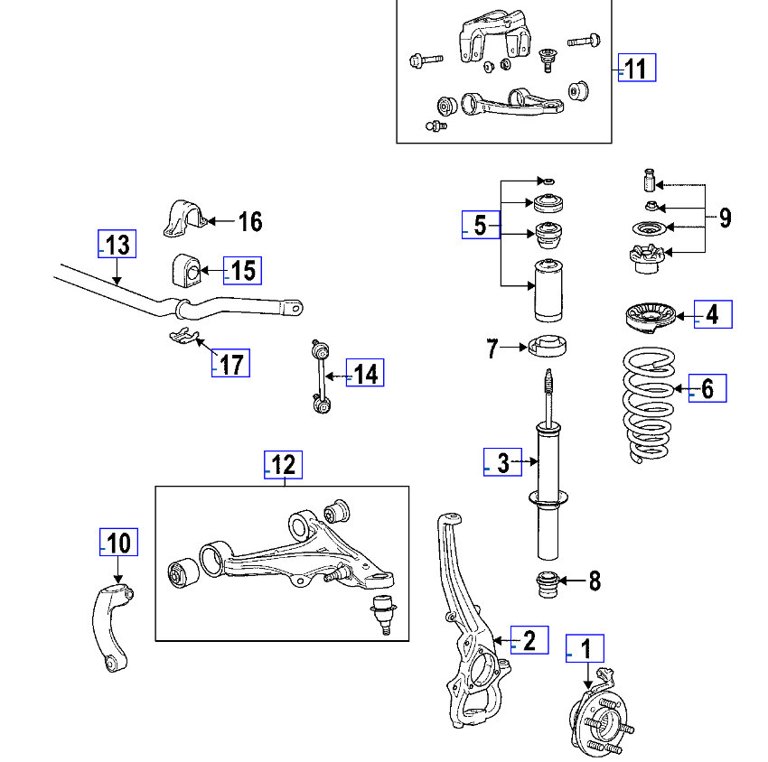

Here is how to install them. Check out the images (below). Let us know how it goes.
